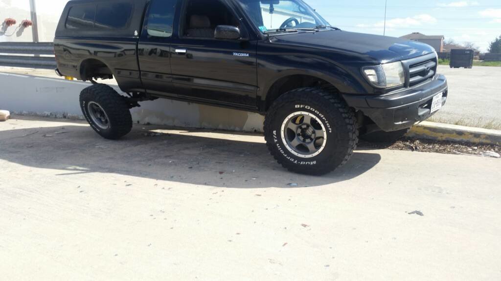

    3" lift EIBACH coils w/ 5100's front, OME/ Dakar leaf springs w/ toytec adjustable shackles at 1.5" and 5125's out back. 33x10.5x15 KM2's Relentless DIY steel bumper.
    I got the dakars and with no weight in the bed the truck sat level. I carry some sports equipment and tools and other stuff so it weighed the bed down a bit. I wanted some rake so I added extended shackles. Eventually I'll add the AAL to the dakars and probably go back to stock shackles. My point is... if you want an even stance with no weight in the bed then just the dakars will be enough. If you carry weight is suggest the AAL. Eibachs give off around 3" maybe a tad more after settling. Also get the BPV bracket and possibly the exhaust relocation bracket or just cut it off
    If your gonna be flexing then I'd suggest extended break lines

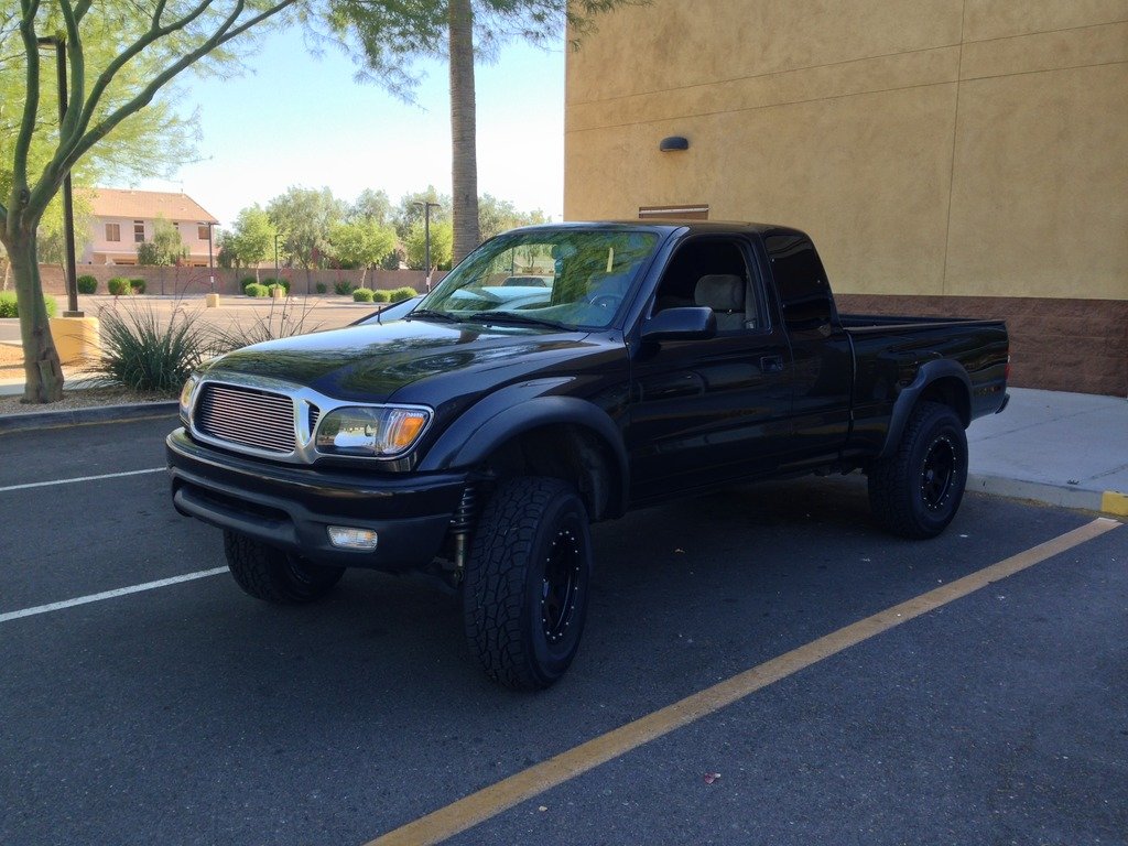

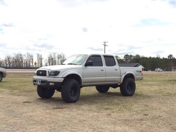

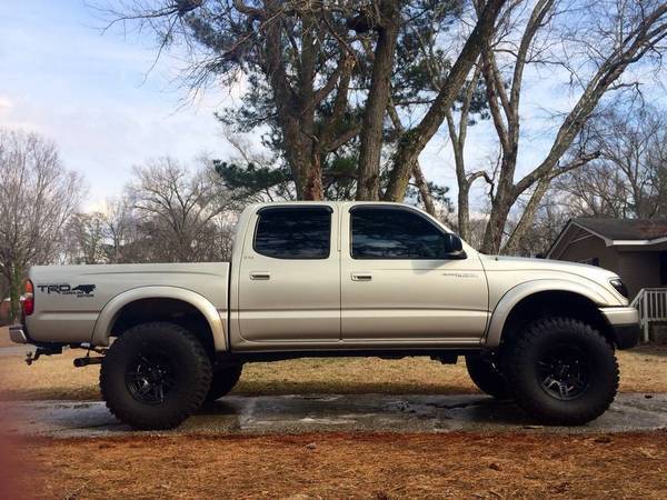

    Got this setup on the new truck. Started with this setup on my old truck and loved it then went to kings but I love my eibachs and billies, new truck rides so good

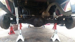

    20150331_172810_zpsopifjixc_ac6150f3c4192aeec8f87dc17f230f2e7ae70872.jpgrear end is finished. Bilstein 5100 with toytec add a leaf.

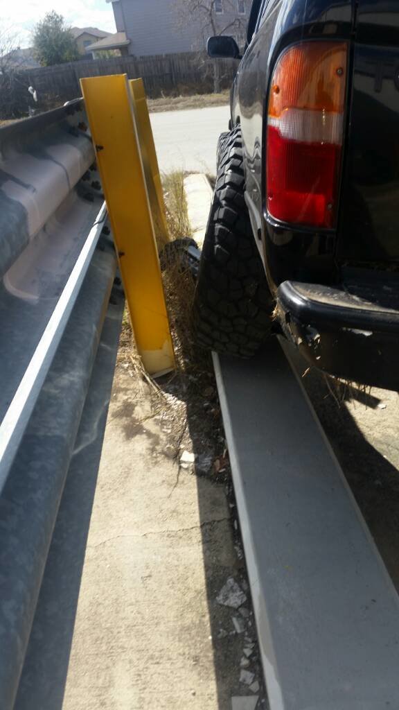

    Yeah I honestly just used a BFH and best the shit out of it behind the wheel. I'm not a running a sway bar either.
    I have full turning radius and it clears.
    Main thing I haven't gotten to. Yet is trimming the besides abit.
    It rubs when I try to flex it out all the way in the back. The trucks body and paint is in pretty damn good shape. I don't have the balls yet to chop into the fender lol 8461a46be7e63f77427ae47bcd5bc023f_477b4b019834f0b5e57c0c5e55a8d95124af1e03.jpg
    The fenders on mine definitely clear 32s all the way stuffed 665d4cc18640dc40d38116ba98993918_bccb4a0d0f6bb5c5db291227fa68f2841d61bd2f.jpg

    Did you buy new or used? i can believe used worn down ones would clear.
    and you must do 0 offroading then haha cause i couldn't even hardly back out of the garage with mine they rubbed so bad when turning.
    R15s or R16s?

    They're brand new.
    I do abit but nothing crazy.
    I have these mainly for street driving around town and wherever I travel too. Which is why I bought all terrains. I have two sets of muds in 32s and 33s . I can swap over too if needed.
    They are 15s . I've only had 15s on this truck

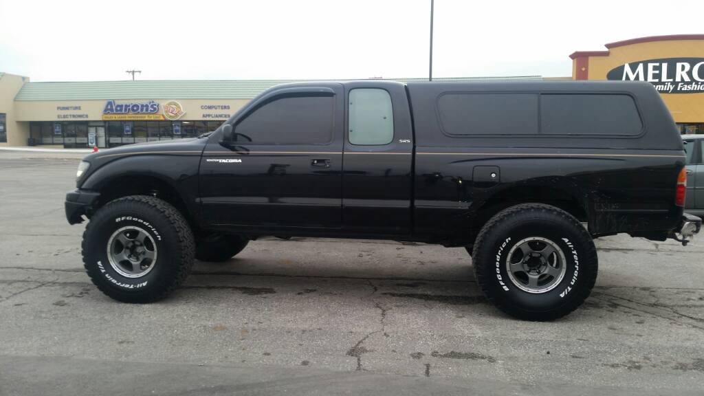

    Just threw the lift on this weekend.

    Looks good! Makes me wish I kept my camper
