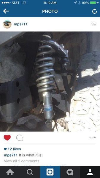

    How are your CV axle angles? Really shouldn't have Eibachs on any other level than 0

    Here is a picture.

    Hmm, that's odd. I was expecting it to be horrible. Maybe the coils settled a lot :notsure:

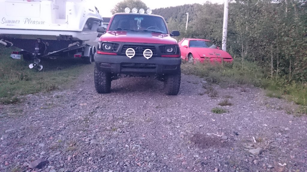

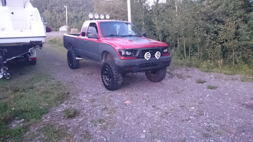

    same... think my angles are worse on stock coils at 2.5. That is the 620lb coil isnt it?

    Should be, I have 5100s and eibachs and it rides super stiff. Looking for other options if my bumper doesn't smooth out the ride

    oops. i was asking him if they were the 620 coils.

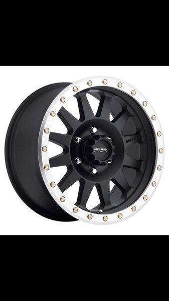

    They are the Eibach 620 coils. This is an off thread question but I just bought 16x8 Method Double standards w/ 4.5" of back spacing. Should I have any trouble? The rims in the picture you saw earlier with my set up were 16". With 265/70/16 and now I want to go with 265/75/16.

    I also have 1.25" Spidertrax Hubcentric wheel spacers

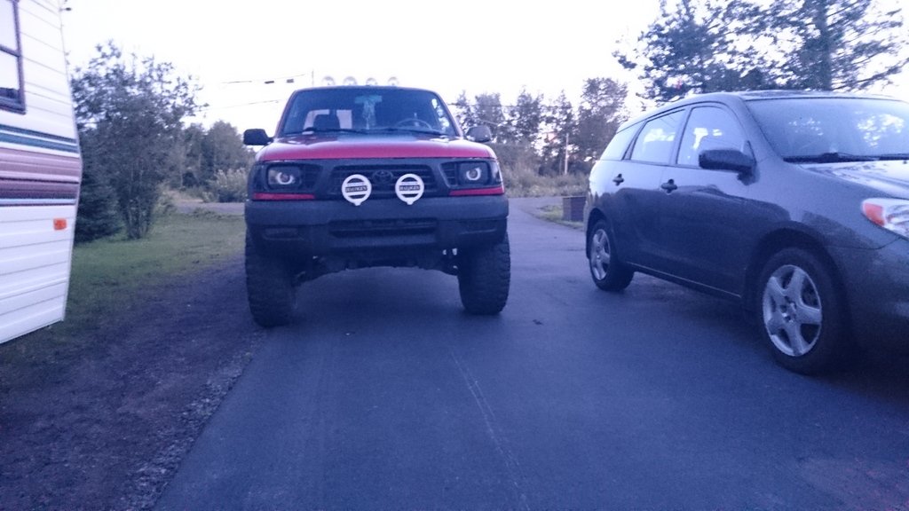

    Fresh eibachs! Got about an inch of lift over the 20 year old stock coils and the ride is quite a bit better. Sway bar is definetly not needed. Thing corners pretty well flat without it.

    You should have got 3" of lift

    over stock coils at the 2.5 setting

    Oh yea you should have cuz the top setting is at 2.25" I believe and the springs will settle
