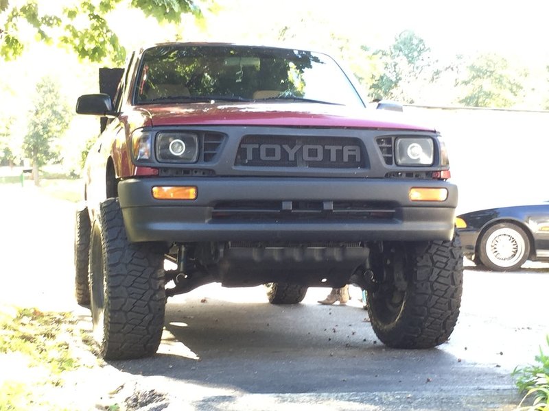

    Also added this setup on my little brothers Tacoma last month
