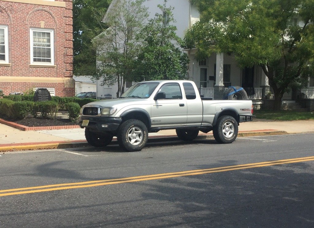

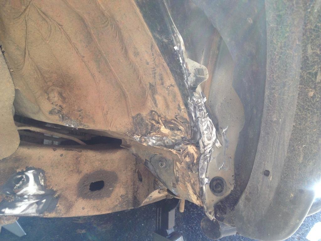

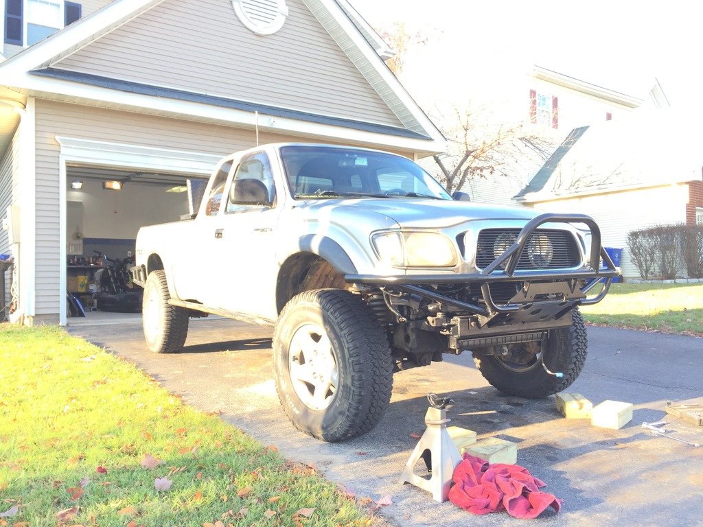

    Drop bracket lift and booger welds
    Before I installed the bumper:
    After:
    Running 5100's with 625lb Eibachs. I also got them used so i'm sure they settled a bit too.
