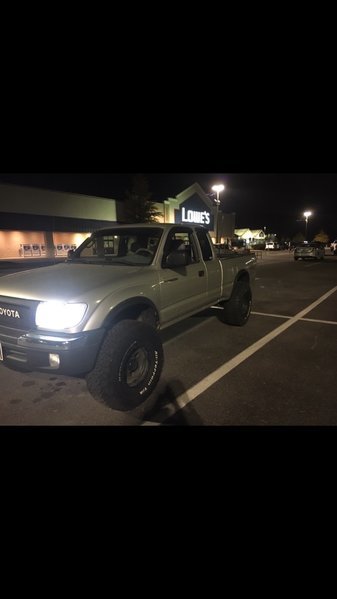

    2000 Prerunner, SR5 2.7 4 cylinder
    15x8 Mickey Thompsons, 2.5 in. lift with Bilstein 5100's. 6K Hids. 33x12.50x15 BF Goodrich K02s
    Bilsteins and 33x12.50x15's
