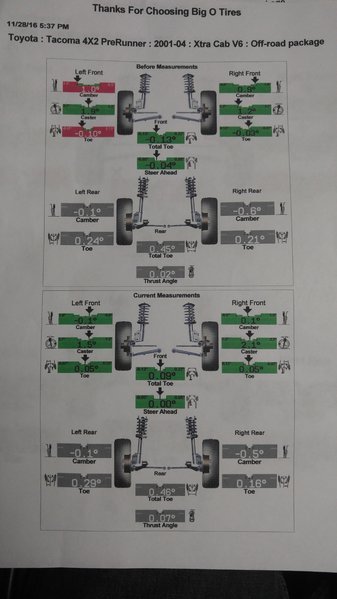

    Ok, back in topic..
    Here she is all buttoned up. Finally. Ha.
    Gained about an inch all around from previous 2" spacers and blocks.
    5100's with eibachs and dakars
    ~3" in front, 3.5" in back.

    @NightProwler
    These numbers are much better. Camber and toe are good and will not cause unusual tire wear. The caster could be a bit higher but is certainly better than before. How does she drive? Been on the highway yet? Steering might be a bit light. Higher the caster, the heavier the steering feel and less susceptibility to road irregularities and side winds.
    It pays to be up front with the alignment techs. They are so used to customers knowing nothing about this stuff, when someone requests something specific, it is like a challenge to them. Some like the challenge and some do not.

    Only drove it home. But initially after the lift, it was a bit squirrely, especially in the wind as it was yesterday.. But that was probly due to the camber being off too.. Extremely smooth now, even better than it ever has been I think. Idk, gotta see. Also took my sway bar off for the first time. Not sure I like it. Again, have to drive it more. Just gotta be careful on speed bumps with these eibachs is all, lol. Other than that, much much better than my old spacer and block lift. Thank you guys for helping me out through all this.:hattip::bowdown:
