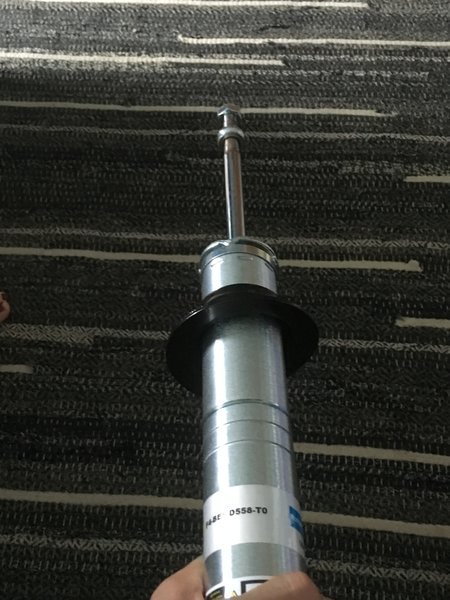

    i just ordered this set up but the question that i am curious about is what setting do i set my bilsteins to get a 3 inch lift with the eibach coils?
  9. Dec 2, 2016 at 11:52 AM
    #2769
    devinzz1
    devinzz1 Well-Known Member
    Jun 28, 2014
    #132892
    6,961
    devin
    lewisporte Newfoundland
    2023 aclb trd or mt
    icon stage 10 kit, toytec 1" bl, 35" general x3s, 17x9.5 procomp wheels, locker anytime mod, s&b intake, blackhawk 2.1 tune,
    Bottom setting ONLY.
  10. Dec 2, 2016 at 5:52 PM
    #2770
    Wave808
    Wave808 Member
    Jul 11, 2016
    #191780
    23
    Tucker
    kauai
    98 tacoma
    icon 3" lift 285-75-16 tint clears and chrome
    Mine are set to 2.75 right? If so how do I go about moving the snap rings down to 0? (Sorry for needing to be treated like a 16 year old, I'm new to this l)

    Yeah looks like it, bring the snap ring down by using a snap ring pliers or using a screw driver

    If you haven't got any ring pliers you can get by with a flat head screwdriver and patience.
    But those pliers are a hell of an investment for $20ish bucks

    Just grab it with needle nose pliers on one side of the gap and pull out/down. Just work around the ring until you get it down to the desired height
