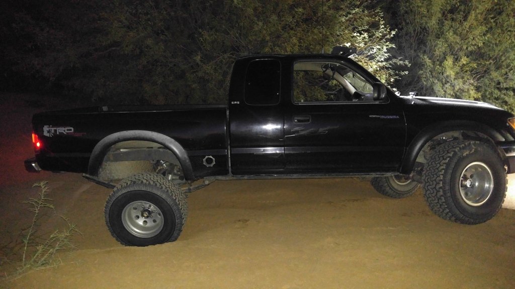

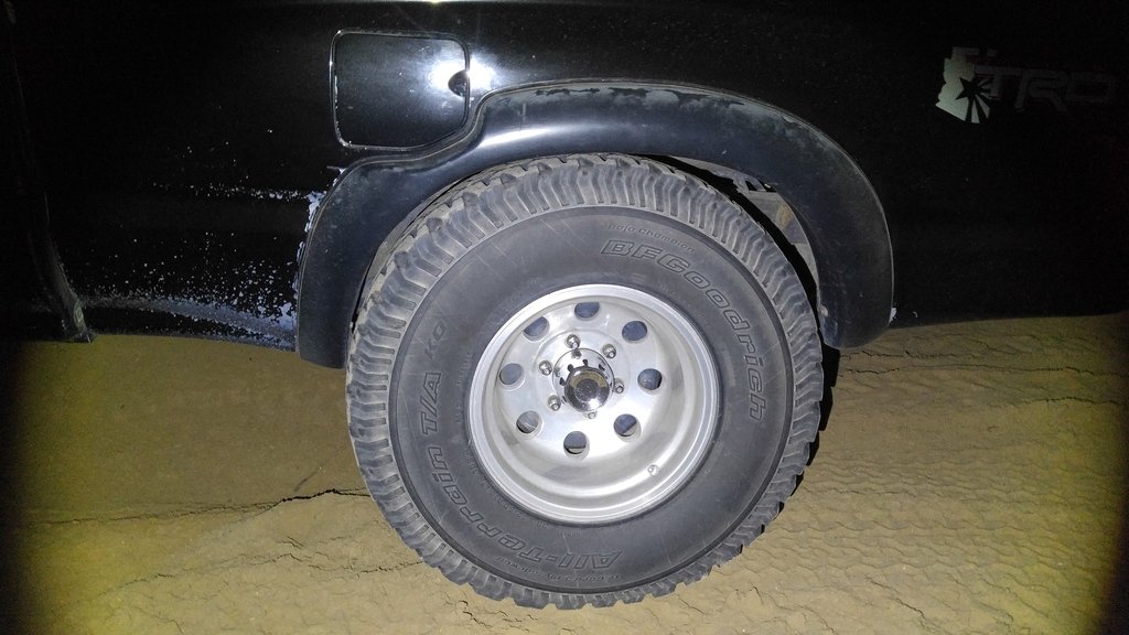

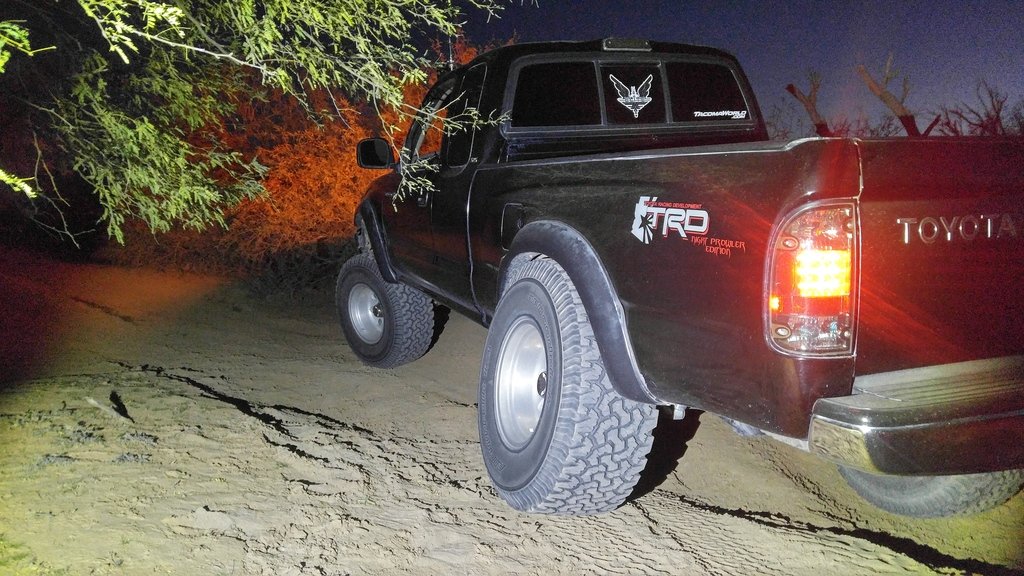

    update. FINALLY had a chance to take a little trail run. She certainly has loosened up a bit since initial install. Still a little rough on the street up front with the eibachs, but oddly enough, is WAY smoother on the trail..
    Tried to flex her out. Think I got it maxed out in the rear at one spot. Which with the 5100's and dakars, is like the perfect amount of flex. Get's my 33's stuffed in pretty good and no rubbing!! I was pleasantly surprised. Especially since people seemed to highly suggest I needed to do a shock relocate with extended shocks in the rear... Plenty of flex for me and MUCH more capable than previous setup with spacers and blocks.
    Had a little bit of rubbing on the lower valence up front, but that'll be gone soon once I get my relentless bumper mounted up. So I will most likely just keep it as is. I wasn't too happy at first with the eibachs, but with my bumper, I think it'll be just fine. I was thinking I was gonna swap to some ome coils and eventually ome shocks, maybe some extended droop coilovers, remove overloads from dakars to even it out as well.. But I'm happy with how it is. And I get to keep my 3".

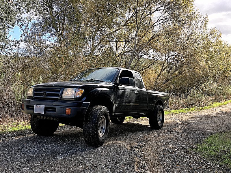

    Need some advice. I have the 2001 Toyota 4dr 4wd in the picture and it has 290,000 miles on it. The suspension is shot. Making sure I understand everything I need to replace it. I will need 5100 bilsteins but what coils?? and what do I need for the rear. I really do not want a lift on it but wouldn't mind if the front end was leveled. Thanks RIck
  16. Jan 19, 2017 at 10:14 AM
    #2796
    Blackdawg
    Blackdawg Dr. Frankenstein
    Dec 31, 2010
    #48500
    81,586
    Monte
    Wyoming/St. Louis
    The Trifecta of Taco's
    OME 880 coils on OME shocks will ride better. It'll seem like it'll be a lift too because your so low right now, you're well below OME specs in terms of height. Just be ready for that.
    Wheelers 4 pack leafs would be nice for the back and OME shocks again.
    The OME shocks are better quality then 5100s.
    If you go to Wheelers Offroad they can set you up with a full kit with the above specs.
