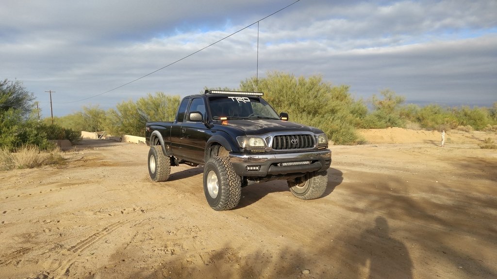

    So has anyone noticed that their passenger side seems more stiff than the driver side at all? Mine does. Idk if this is normal or what. Would make sense since there's more weight on the driver side. The shocks/coils aren't side specific right? Just the 3/8 spacer that I installed on the driver side to combat the lean...

    Both shocks and coils are the same. Rear shocks have same valving per side aswell

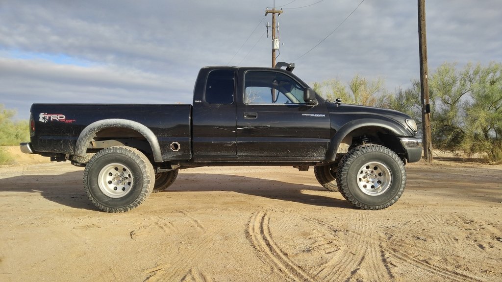

    2000 Tacoma Prerunner V6 2WD

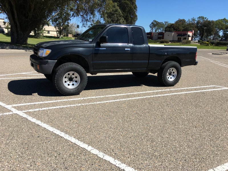

    5100 Billy's set at 0" with 881 coils
  9. Mar 9, 2017 at 12:35 PM
    #2829
    Sicyota04
    Sicyota04 Slowly but surely.
    Jan 9, 2015
    #145940
    3,553
    Morgan
    California
    04 DC 4x4
    Is there a 100 lbs of sand bags in the bed of the truck?

    172
    STEVEO
    Hahaha nope, 80 pound bag to be exact lol no the sag is from my 100% worn out leaf springs..

    Nick
    Oregon
    97 Tacoma 2.7l Single Cab
    Ha, that's how mine looked before my dakar pack. Stiffer than anything, but got about +4-5 inches with the overload spring.

    What size tires are these? 285?

    33x12.5x15

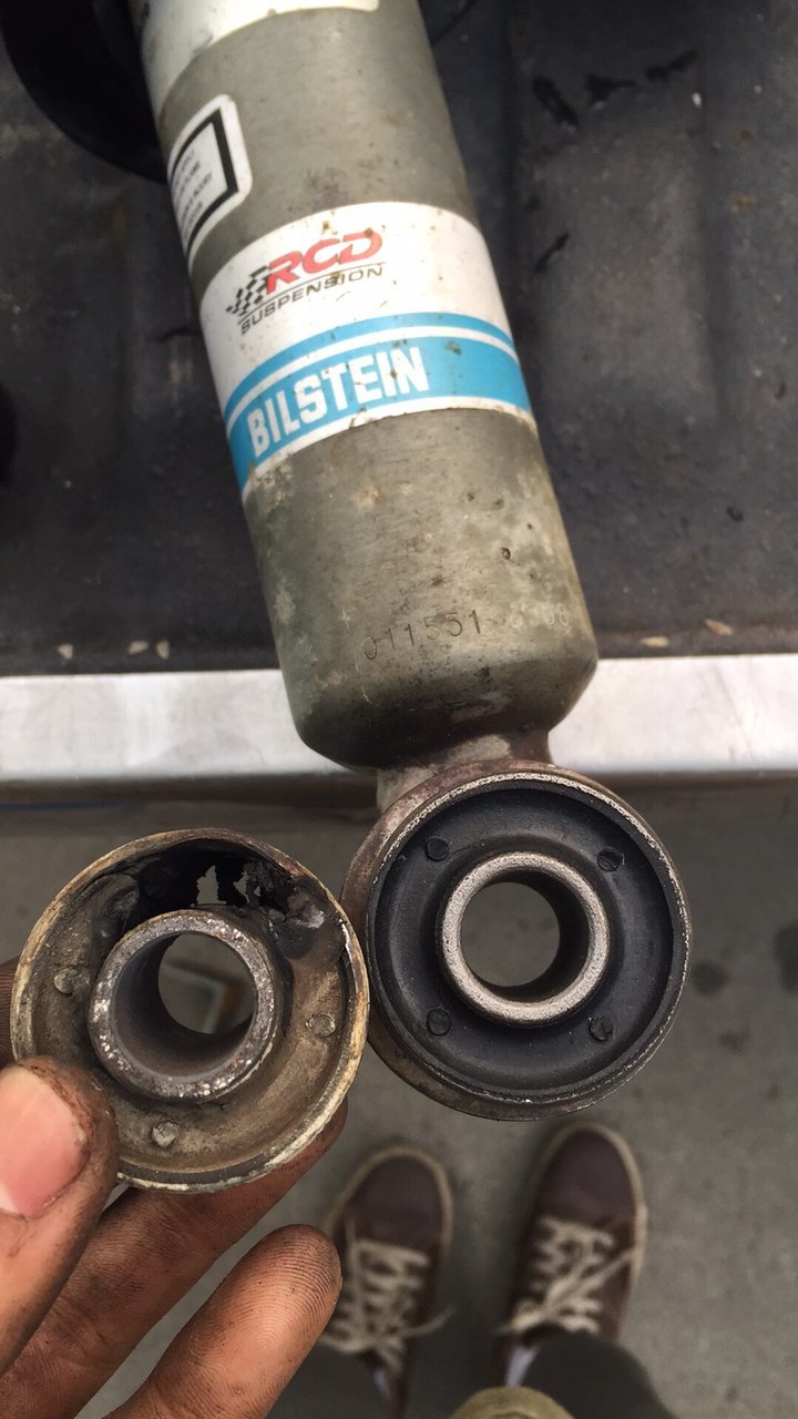

    3" suspension lift (Sway Away 2.0 Racerunners with eibach 14" 650lbs coils) All Pro Offroad Rear Expo Leafs w/ toytec boss shocks 4crawler 1" body lift Trail gear front bumper & rock sliders Trail gear rear bumper w/ custom tire carrier 33x12.5x15 Cooper Stt Pro Glare led 42" curved lightbar spidertrax 1.25" wheel spacers on the front Smittybilt 9500 winch Trd E locker w/ 12voltguy harness
    after 80,000km the bushings gave out on mine and the new moog bushings didn’t even last 15,000km, just ordered the new style 5100’s has anyone else tried the new style out?

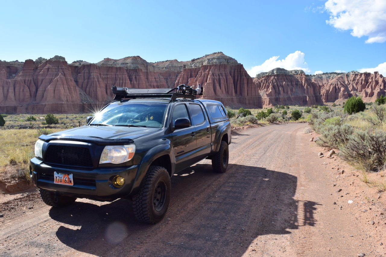

    Bilstein 5100's front & rear, Eibach 620 lb Coils, Dakar Leaf Packs, Rear Diff Breather Mod, All Pro Sliders, RCI IFS Skid
    Hey all, I have a question that I am hoping to get feedback on if possible. I have a DCLB 4x4, and currently have the Eibach 1.6” lift springs paired w/ 5100’s set to .85” upfront, and going to swap out the Eibachs this Friday w/ the 2.5” lift springs and drop the 5100’s back to the 0” setting. The current coils have sagged (been on there for 5 years) and only have a total of about 1.5” lift (22” measurement from center of hubs to fender).
    I am needing some extra weight support as I am going with a hidden winch bumper and winch soon, and also looking to be more level as I currently have about a 2” rake (Dakars in back, sits at 24” mid hub to bottom fender).
    My question is, after reading a bunch of varying info here and around, is there anyone who knows based on experience, approximately how much lift I will get out of either A.) just adding the 2.5” coils or B.) also including the 1/2” plate spacers (says on Toytecs site that these give either 1/4” or 1/2” depending). I know that with the DCLB achieved lifts heights are lower than stated, but also don’t want to go over 3”, be nose high and have to add aftermarket uca’s (which I will eventually, but wanting to hold off if I can).
    I appreciate the help!
