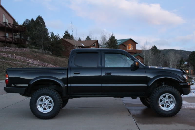

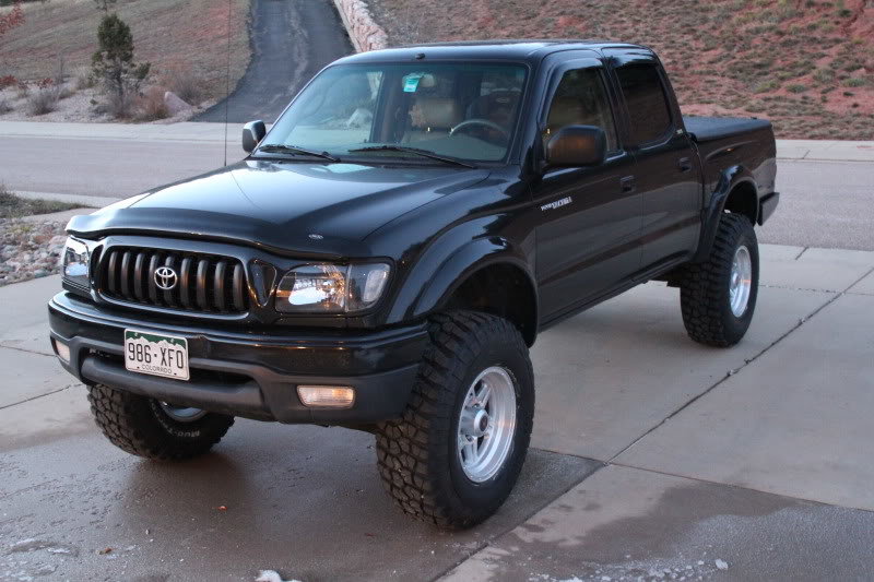

  17. Nov 5, 2011 at 8:20 PM
    #317
    Okiyota
    Okiyota Well-Known Member
    Mar 1, 2011
    #52084
    233
    Breckenridge, CO
    2001 Dbl Cab
    2.5" Icon ext travel coilovers, Icon uniball UCA's, OME Dakar's, Icon 2" rear shocks, 285/70/17 Maxxis RZR MT's, 17" SCS Copper Ray 10's, Shrockworks front bumper, CBI rear high clearance bumper, Bash Fab sliders, Shrockworks full skid plate set, rear frame plated, All Pro u-bolt flip kit, Wheeler's Super Bumps, VisionX LED's...
    Just put them on today, with Total Chaos upper arms and a complete All Pro 3" rear kit...
  18. Nov 5, 2011 at 8:22 PM

  19. Nov 5, 2011 at 8:31 PM
    #319
    Konaborne
    Konaborne Pineapples on pizza Hawaiian does not it make.
    Nov 21, 2010
    #46536
    31,902
    Cody
    Kealakekua, Hawaii
    Lifted 00 TRD Off-Road
    fox extended travel remote resivoir coilovers, 14" eibach 600lb coils, All Pro tubular chromoly 1" uniball upper control arms, All Pro expedition leaf packs, 10" bilstein 5150 piggyback reservoir shocks 265/75r16 Goodyear wrangler MT/R kevlars wrapped around 16" Helo 791 gloss black, Mini H1 retrofits with 6000k bulbs, 18" magnaflow w/custom exhaust reroute various decals, Sockmonkey retro hood stripes
    this thread keeps you busy eh chris
  20. Nov 6, 2011 at 8:02 AM
    #320
    Okiyota
    Mar 1, 2011
    #52084
    233
    Breckenridge, CO
    2001 Dbl Cab
    Thanks guys, tires are 285/75/16.
