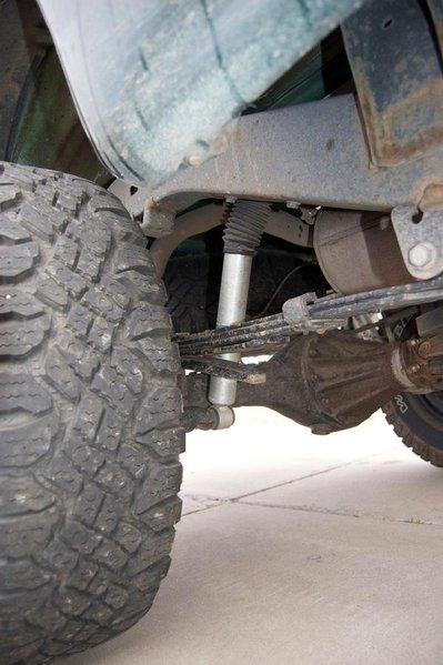

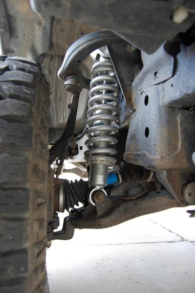

    Toytec 2.5" lift., just the beginning. Front Builstein coil-overs fully adjustable from 0-3". 2" AAL in the rear with 2.5 degree shim. Total Chaos uni-ball UCA's.
    Here's my billy setup. Front coil-overs w/eibach and rear aal with 5100's.

    im getting the eibachs 5100s and toytec AAL. since i have the I4 will i get any bro lean?

    oh yea lol prolly quite a bit at first. Your gonna get like 3.5'' of front lift with th I4.

    If you get the adjustable coil-overs no, you can adjust them to get rid of the bro lean. I would highly recommend doing the rear AALs first, then when you install the front coil overs you can simply dial them down to get rid of any excess lift in the front. Make sure when you order your springs you tell them that you have an I4. They will make sure you get the right rate springs. Call them and they will get you the 500# coils instead of the standard 600#'s that they come with in the drop down menu. They were extremely helpful in helping me determine everything that i needed.
