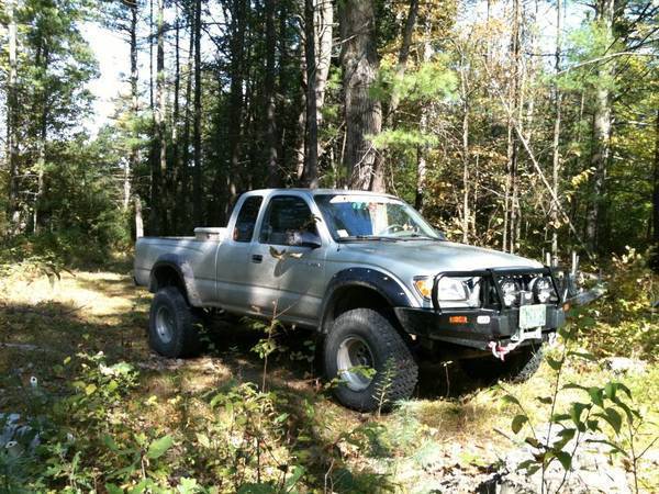

    On my Tacoma I used to have the 5100s with OME 882s then I put on a ARB bumper with a winch. That was too much weight for the 882s, the front end dipped too low and my tires (33x12.5) were rubbing when the steering was turned all the way. They did not before, albeit after quite a bit of trimming. I debated on going to 886s or Eibach 620lb coils. I actually picked up the Eibach coils, but used them on my 4Runner instead. I decided to go with Toytecs adjustable coilover kit for the 5100s for my Tacoma. I like the adjustability factor, I dialed them in to restore the level stance. For the rebuild I replaced the bushings and purchased a new set of upper mounts, KYB brand. I placed the coilover kit over my old 5100s, but the shocks just looked nasty next to the shiny new Toytec kit, so I refinished them with some red paint. I used to lowest notch on the 5100s.
    Here are some pictures after I dialed in the adjustable lower collar. I supported the truck with a jack to do the adjusting to lessen the tension on the collars during the adjusting. I did this at least 4 times to get it to where I am now. The instructions said to leave only 1" of thread showing, but at that setting I was still rubbing, so I ended up with a little more thread exposure.
