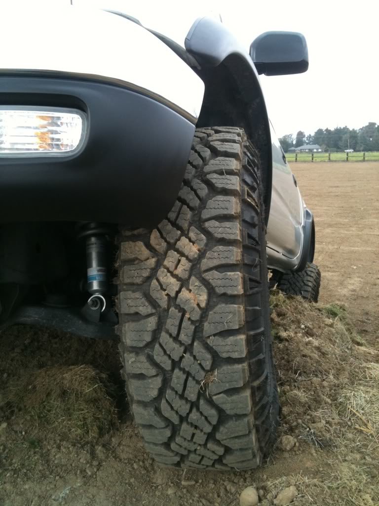

    Alpha Q Up
    Alpha Q Up Well-Known Member
    Aug 18, 2011
    #61921
    2,325
    Ruben
    San Jose
    2003 4WD DC Tacoma
    Here's a nice shot of a Billy

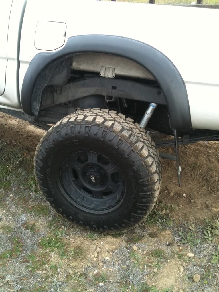

  18. Dec 12, 2011 at 10:49 AM
    #458
    01Yota
    01Yota Well-Known Member
    Aug 23, 2011
    #62206
    271
    Jonathan
    Kentucky
    2003 toyota tacoma 4x4 Little monster truck
  19. Dec 12, 2011 at 12:01 PM
    #459
    wolfgang123
    wolfgang123 Well-Known Member
    Jul 7, 2009
    #19369
    1,913
    Skyler
    Charlotte, NC
    1997 TACOMA - 4x4
    ^^^^specs dude?
  20. Dec 12, 2011 at 12:02 PM
    #460
    01Yota
    Aug 23, 2011
    #62206
    271
    Jonathan
    Kentucky
    Its have bilstein shocks and a wheelers leaf pack and OME coils sitting on BFG 285's 75 17
