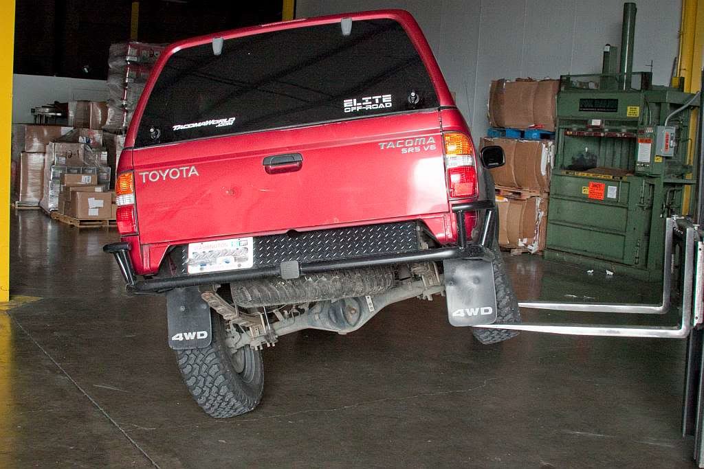

  6. Feb 10, 2012 at 7:34 PM
    #546
    Blackdawg
    Blackdawg Dr. Frankenstein
    Dec 31, 2010
    #48500
    81,617
    Monte
    Wyoming/St. Louis
    The Trifecta of Taco's
    All the billy shocks are the same except you can get 5125s i LOTs of different lengths as and 5150s you can get in some different lengths as well plus they have a res.
    Best way to know is really to just wait till you have the leafs and everything on. I found this out the hard way. I bought just some regular 8.5'' travel 5150s(good for about 2-2.75'' of lift) but actually ended up with 4.5''. So then i have to order another set of 10.5s. DSM said the 11'' travel 5125s would suit be better...but i wanted the 5150s..:p haha
    there is nothing wrong with driving around for a week or so with no shocks. I did it with no problems. So just wait. Take the proper measurements and then call DSM and they will hook you up with the best Billy shock for you.

    Thanks Blackdawg.. I'll search for a write up on how to measure in the rear, I know its just flexing and you measure the how far to flex up and down. I just dont know the points to measure from.
  9. Feb 11, 2012 at 5:14 AM
    #549
    01Tac0ma
    01Tac0ma Bash Fabriction & Off-Road
    Jun 11, 2010
    #38782
    6,304
    Chad
    West Columbia, SC
    SAS 01 TRD 4x4
    Look at build!
    Full compression from shock mount to mount hten ful extended flex same thing

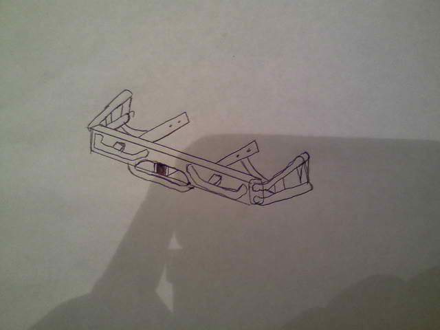

  10. Feb 11, 2012 at 5:15 AM
    #550
    01Tac0ma
    Jun 11, 2010
    #38782
    6,304
    Chad
    West Columbia, SC
    SAS 01 TRD 4x4
    Look at build!
    Hybrid :spy:
    Crappy drawing but you get the idea
    and after thinking about it a bit more it might be closer to 100lbs

    Make sure when you measure that the rear shocks are disconnected so there is nothing to limit the flex.
    If you have access to a forklift, it is really easy to get measurements.

    I have access to a lift, tractor, and at school there is some cement ditches that flex my truck out to the bumpstops lol.. I'll figure it out..
