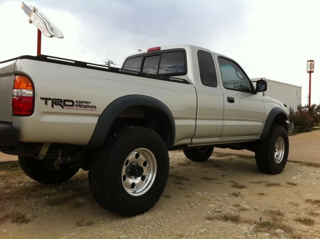

    Here's my Eibach and 5100s set-up. Love it!

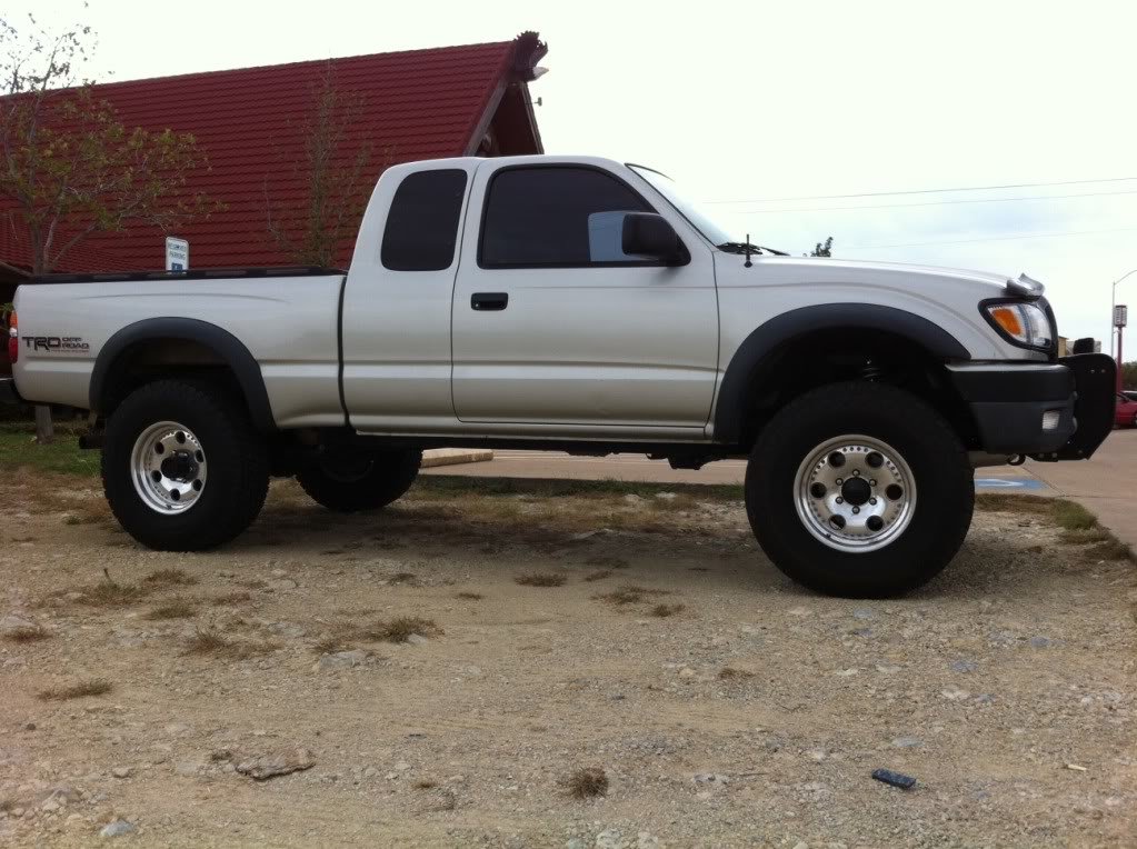

    Does anyone have a link to purchase the Eibachs and 5100s? And thats all I need for the lift right?

    Ok. Im not planning on installing this myself so well see what happens. And this will give me 2.5 ish inches of lift depending on spring sag?

    Yes, maybe even 3" at first.

    ok sweet. I dont need an AAL?

    You will need an AAL if you want to be sitting level.

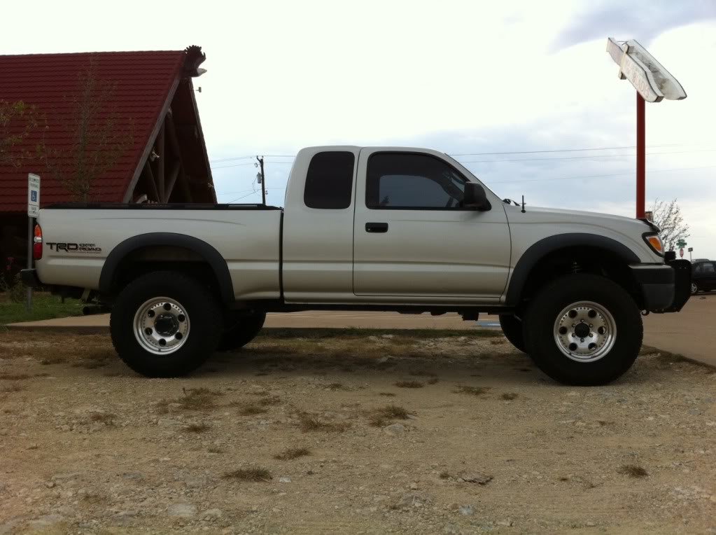

    You don't HAVE to have to though.... here's what my truck looked like after I installed the 5100s/eibachs before I lifted the rear. :eek:

    No, you'll get +3" of lift from the coils, and you might need more than an AAL.
    I think i got 3-3.5" of lift, and i needed 3" leafs

    And yes, I actually drove it around like that for about a week! :D
