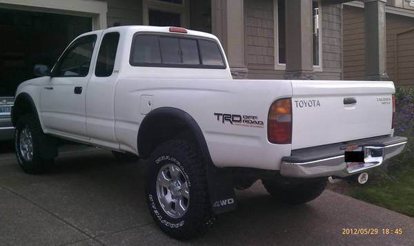

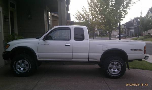

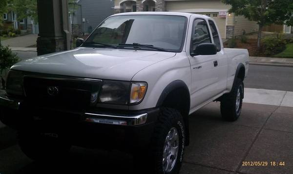

    Installed yesterday!

    Looks great! What set-up did you do for the rear?

    Toytec's 2" AAL (made by Deaver) along with the standard length 5100s. New u-bolts as well.

    Toytec 2.5" lift., just the beginning. Front Builstein coil-overs fully adjustable from 0-3". 2" AAL in the rear with 2.5 degree shim. Total Chaos uni-ball UCA's.
    Nice Job. I have the same setup.. Love it so far. I would recommend that you re-check your torque after about 500 miles.. I was starting to loose a u-bolt nut, and realized it when i checked after 1000 miles (thank god i checked or i would have lost it). Sweet build though.. Your truck is in great shape.
