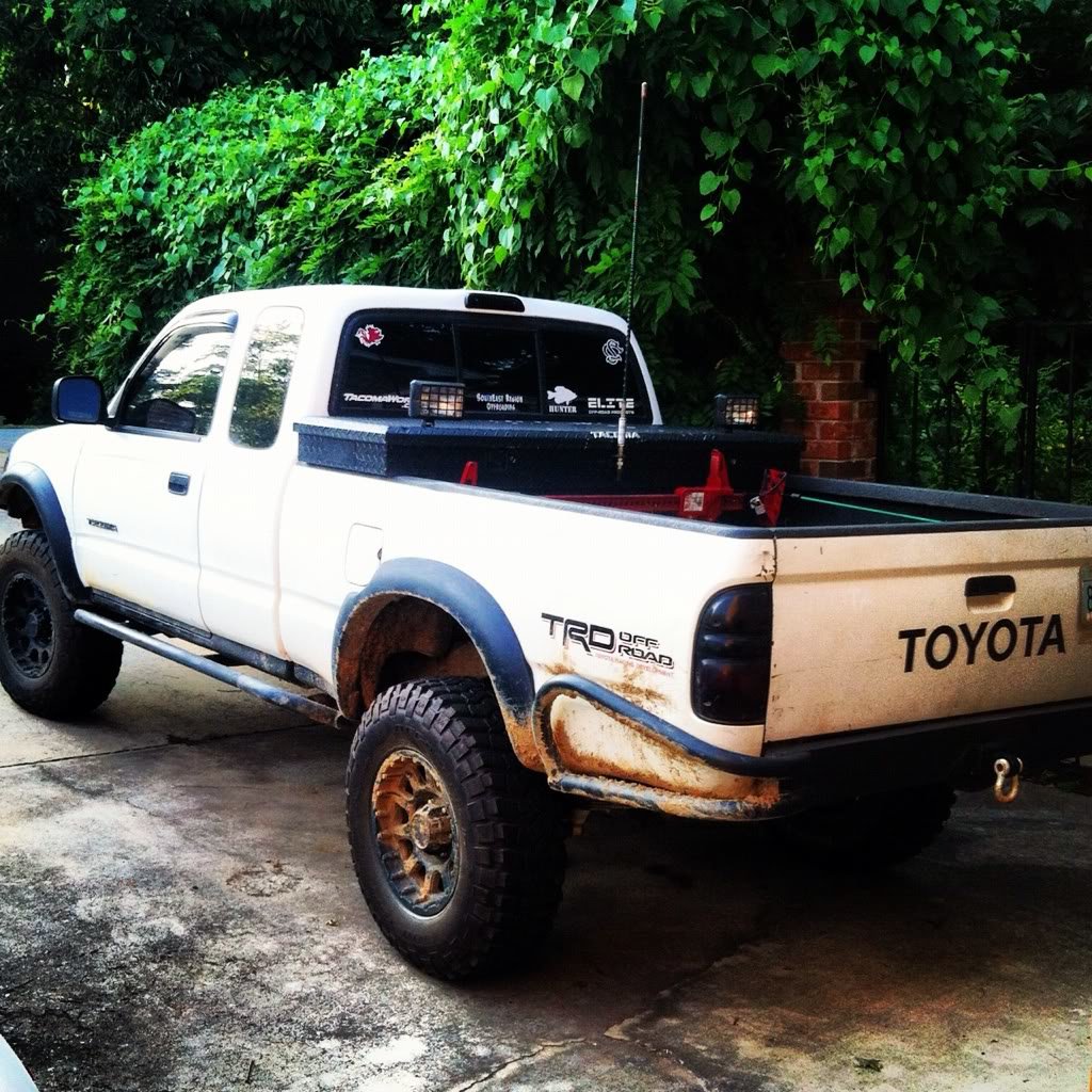

    Well i want 285's but i couldnt pass up the deal on these 265's that were brand new at the time plus ive never really had any major difficulties clearence wise with these but when these die ill goto 285 or 33 12.5 that buddy is selling to move up to 35's plus as soon as i save up for sas im going to 35's so i dont really want to spend a ton of money on tires to turn around and need a new set soon after...
    & i like the rear rake as well, 4" out back and 3 up front is tits! I dont have as much weight as you but i do have about 100lb rear bumper, hilift, and probably 260 lb toolbox even though its not really in the rear but my bedrack wont be as complex as your, more like a spin off of boxrockets with some added touches.
    Plus my yeti has to weigh about 100lbs at all times and it sits at the tailgate as well as my spare tire, but im getting there and so far they are holding up great!
    Heres a current pic
