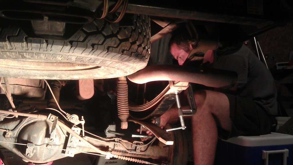

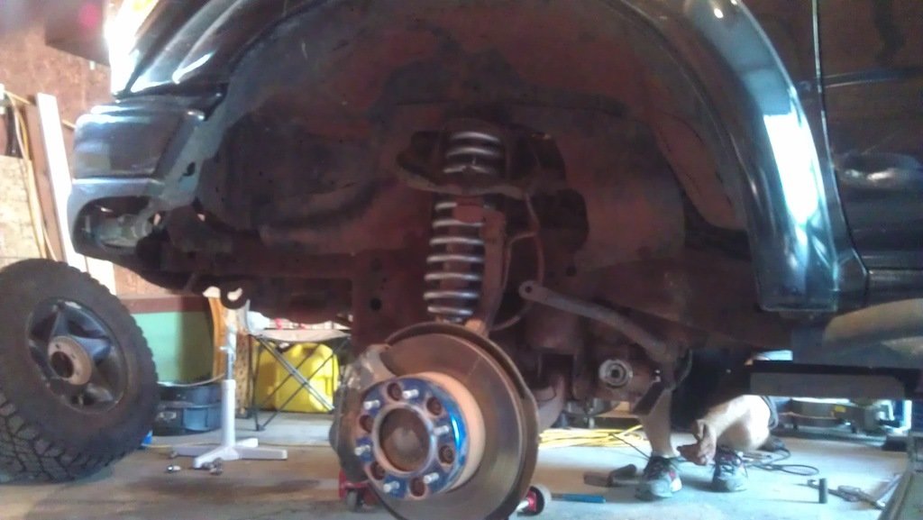

    Already posted in the "What have you done today" thread, but plastering this here for posterity.
    So. I went from OME 881's with ~1 year of use/13k miles. To Toyec/Eibach 112-620's up front. In the rear, i had bought the Wheelers 5-Pack on a group buy at the same time as my 881's.
    I installed the 2" AAL from Wheelers, and 3* axle shims from Toytec. (Little did i know, the shims actually gave me .25/.5 of additional lift as they're basically small tapered blocks.) The 2" AAL apears to have given me closer to 2.5, At first it was a solid 3, but after about 45 miles, they've settled and i'm relieved. I figure with my topper on or a full load, the 2.5 will quickly settle to 2" which is exactly what i wanted. While we were in there, i replaced the inner and outer tie rods. Inners are Napa's high end line, outers are Moog greasables.
    Also - there's a video another member linked to that works AMAZING for swapping coils. Obviously, attempt at your own risk, but for us, everything went smoothly and it was way easier than using a spring compressor (which we used to install the 881's) or paying someone to swap the coils. http://youtu.be/vkVLBOnAifc
    Before:
    FL: 22"
    FR: 22"
    RL: 23"
    RR: 22.75"
    After:
    FL: 24"
    FR: 24"
    RL: 25.75"
    RR: 25.5"

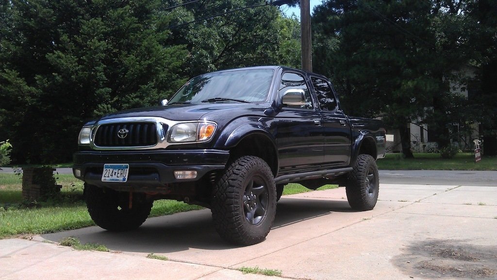

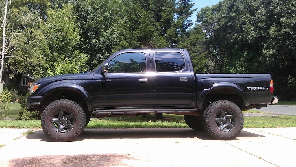

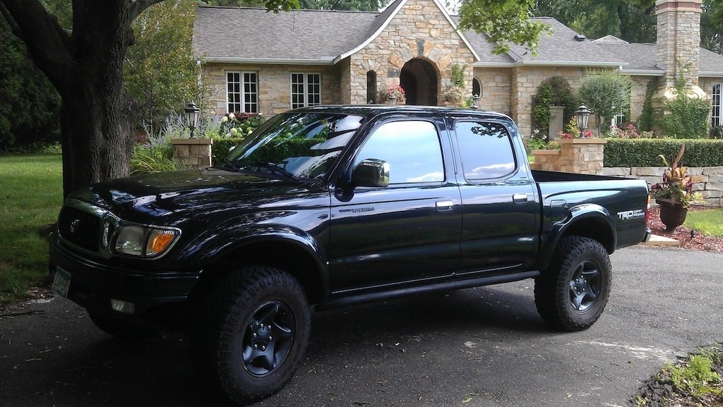

    Before:
    (at my inlaws place)
    During:
    After:

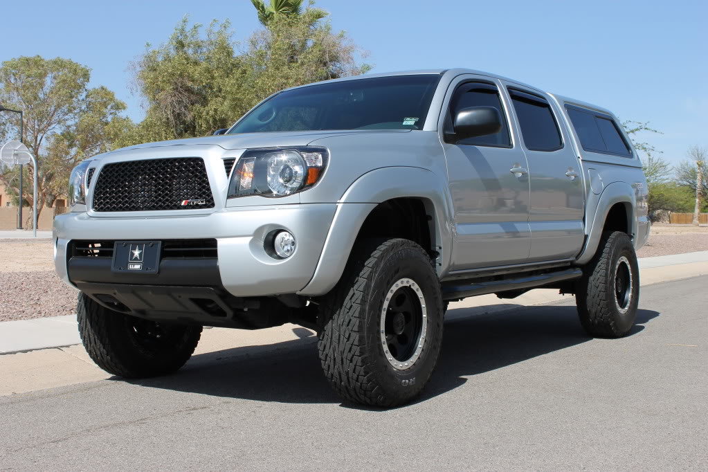

    Elizabeth, Indiana
    2011 TRD Off Road DCSB Prerunner Skeewped
    Here's mine with the 5100s and the Eibachs.
    At least until my Maxtrac spindles get here this week...
    :yay:
  9. Jul 22, 2012 at 5:34 PM
    #789
    RMAN808
    RMAN808 S)(AKALO)(AWAII
    Feb 14, 2012
    #72797
    3,263
    Reid
    Pearl City, Hawaii
    '17 TRD OR 4X4 Quicksand
    Wow! That looks really really good man :thumbsup:
