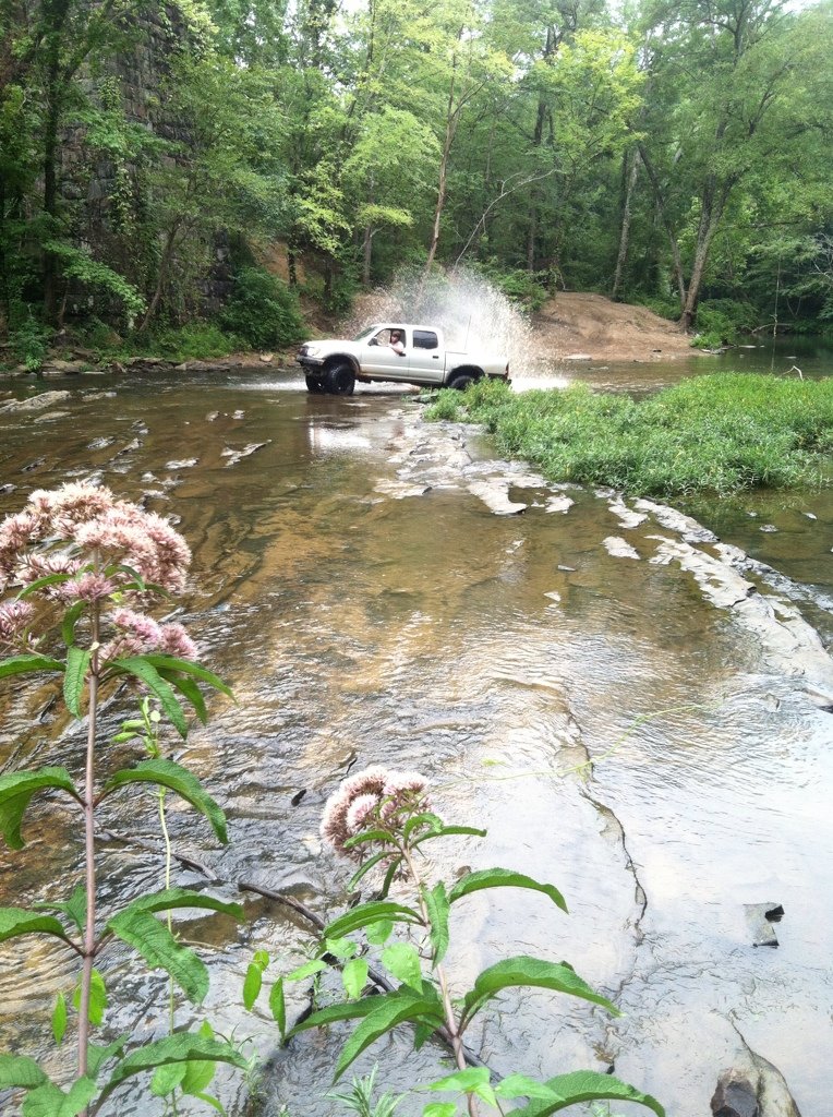

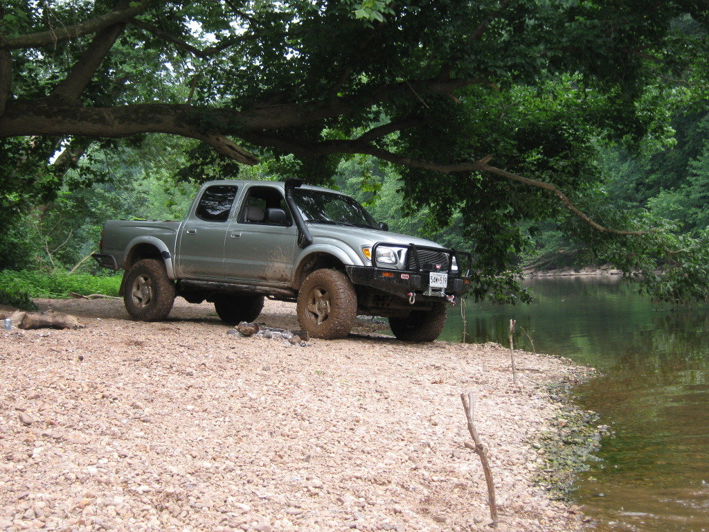

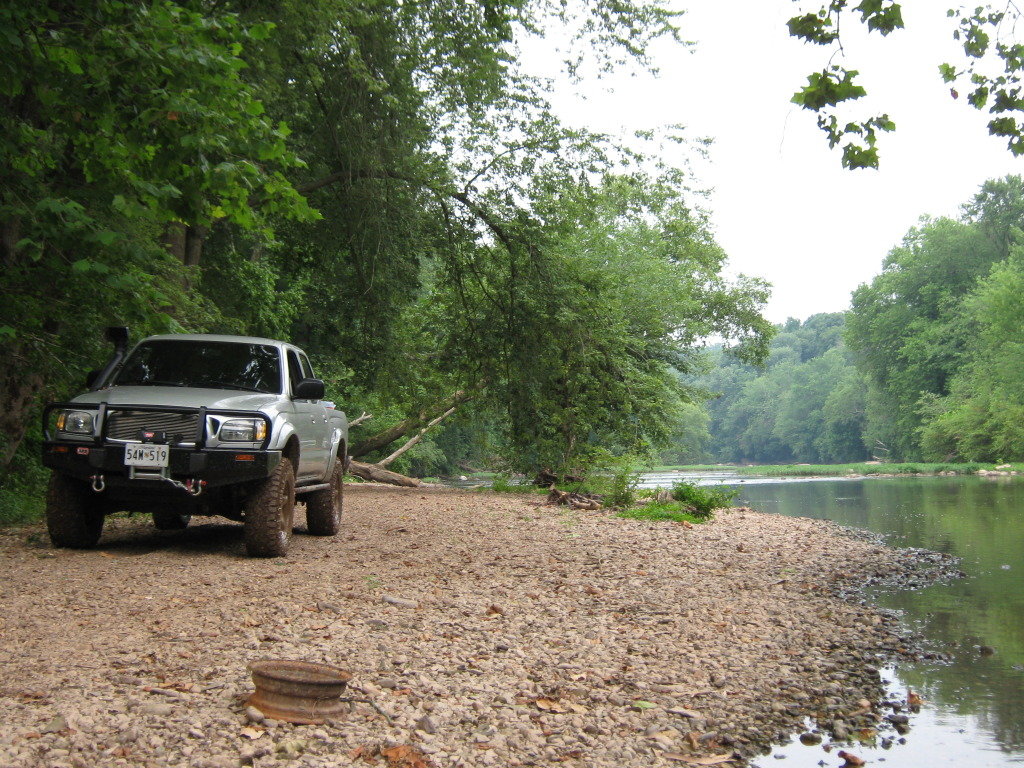

    Some recent pics of mine. I think all the weight of bumper, winch and full skids is sagging the coils a bit more than I'd like.

    & that ARB looks really good on there too! Ive also noticed a little sagging with mine but not as much as yours looks but im sure your bumper is a bit heavier than mine and i dont have a belly pan and my tires are 32's so the space between them an fenders looks like alot more. What are your measurements from center of hub to bottom of flare?
    Also i have the 1/4" spacer on my driver side and it hasnt had any affect on me. Id recommend them for that extra 1/2" or so of height back

    Thanks man. The snorkel is really a "just in case" mod. Hopefully I never swamp my truck and ruin the interior. But better to have it and not need it......
    Anyways, I'm running 265/75 Duratracs in those photos so they should be just slightly smaller than your 32's. My hub center to bottom of the fender flare is 22 3/4" passenger side and 23 1/8" driver side. I'm also thinking the double cab probably weighs the front down a little more too. What are your measurements?

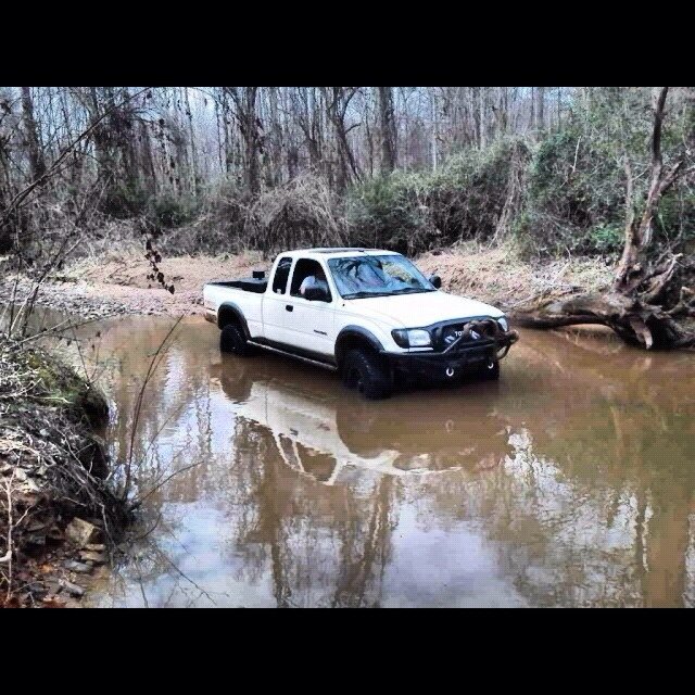

    Same reason i want a snorkel! For those just in case moments when this....
    6165A3A3-F760-4153-BB0D-65C2C790AEC1-232_75d996c8725304221091a06375aa8264400082dc.jpg
    Or this...
    0E17C942-2F2A-426F-9D51-0AE787ACD6A5-232_c01f2937beaa88d4d6418a5b06f423d523573813.jpg
    Coulda turned into an "oh shit, we're gettin deeper" moment lol
    & km2's run small in size so they are probably similar to yours but i want to say im at 23.5-24". I posted it in here a few pages back but cant remember exactly but its one of those 2. & i bet the dC does add a bit more to it, i would get the top plate spacers if i were you.
