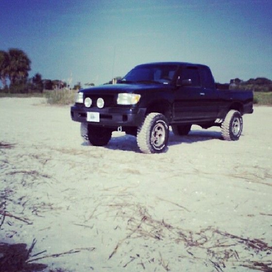

    Finally got some 5100s put on the front a few weeks back to level it out and new 265/75/16 Duratracs yesterday. It's riding better than ever now.
    Also I got tired of the dash rattle and went to local hardware store and got some rubber tubing and was able to get two rows of it between the front glass and dash. It has helped a ton.

    Clean Rig^^^

    Damn good looking truck
