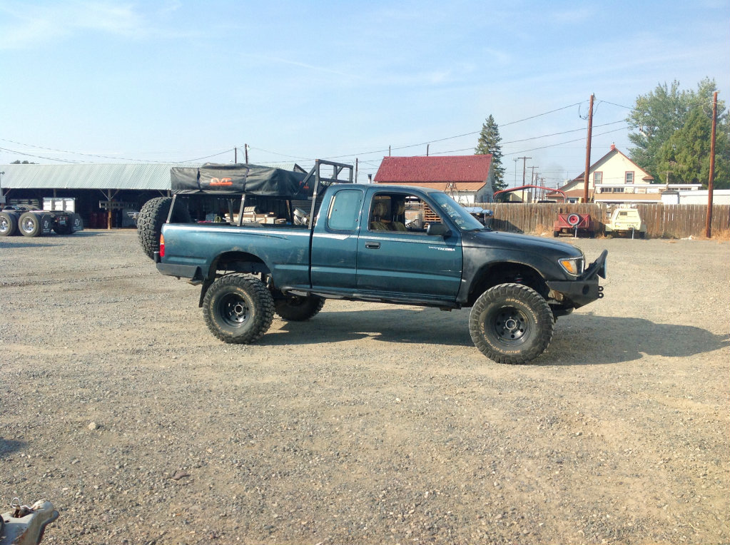

    Half ass washed mine..

    haha that really is half assed, i can see dirt and stuff on the bed

    yea i just rinsed it off lol was a lot lot worse before. Could even tell the sliders, wheels or rear bumper was black..
    but im going out again this and next weekend..whats the point haha

    have you ever noticed, that the rear axle sits further towards the back of the fenders instead of center? i noticed when i tried them 16" eagle alloys, and 285/75/16 yokohamas on. and it showed real bad. and yours does too.:confused:

    i have that same problem so when im fully flexed i only rub in the rear if it waa centered they wouldnt rub much.. is there anything to fix that ?

    yep..a saw ha
    and that'll vary by leaf pack too. When i was rebuilding my leaf packs i first used a Skyjacker main leaf..it brought everything more forward so it rubbed on the front of the fender. I went back to the Alcan main leaf.
    Its really not that bad tho..i mean my tires rub on my front elite bumper too when fully stuffed..
