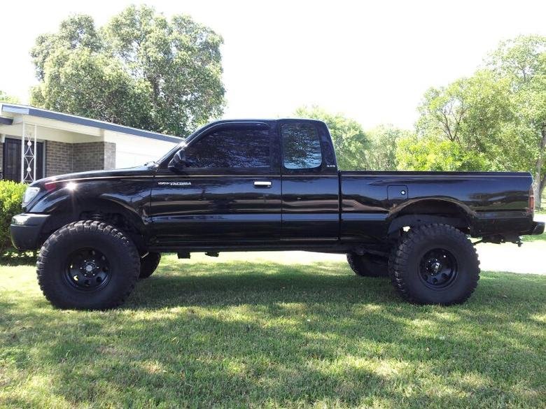

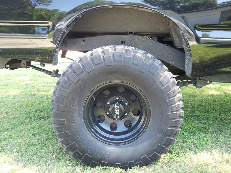

  19. Oct 31, 2012 at 11:03 AM
    #1299
    tc98tacoma
    tc98tacoma Well-Known Member
    Nov 5, 2010
    #45752
    4,217
    Nik
    San Antonio, Texas
    98tacoma4x4
    3inch toytec coils 5100's, aal(soon to be replaced), 33/12.5 km2s, + a money hole...
    The all pro leafs make my 33s look small!
