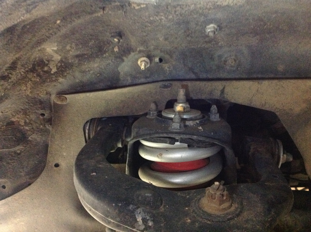

    Ok I installed my Eibach's and 5100's today. After taking 4.5 hours to get everything out of the truck we assembled the new struts. Put them in the truck and everything went fine until I drove it. Living on washboard roads as I drove the truck over the bumps I was hearing a metal on metal sound. I figured out what the problem was but I dont know what I missed in the strut assembly. Here is a picture
    of the problem.
    There shouldnt be a gap between the nut on the strut assembly and metal washer.
    Any ideas?

    Yea that should be there..you did order new bushings? It seems you have forgotten one..I'd guess the lower one. Way too much space there

    Should be like so

    Hmm i didnt order new bushings but other then the gap mine looks just like the picture you posted.

    Yea your top bushing isn't being pressed down at all. I think you forgot something during resembling.

    Bottom washer?

    Yeah. I must have. Im going to take it all apart tomorrow morning and check to make sure everything is there. We will see what the outcome is...

    I didn't get new bushing when I installed my struts since I got both my billies and eibachs used. Looks like something is missing from the top-plate/bushing assembly. Who did you have assemble your struts?

    Assembled struts myself. I found what was missing. Its what i would call a bottom washer. Its a like 2 inches wide or so. I will throw it on tomorrow and see what it looks like then.

    That would do it!

    Well i got it fixed. Now its time for some pics.
