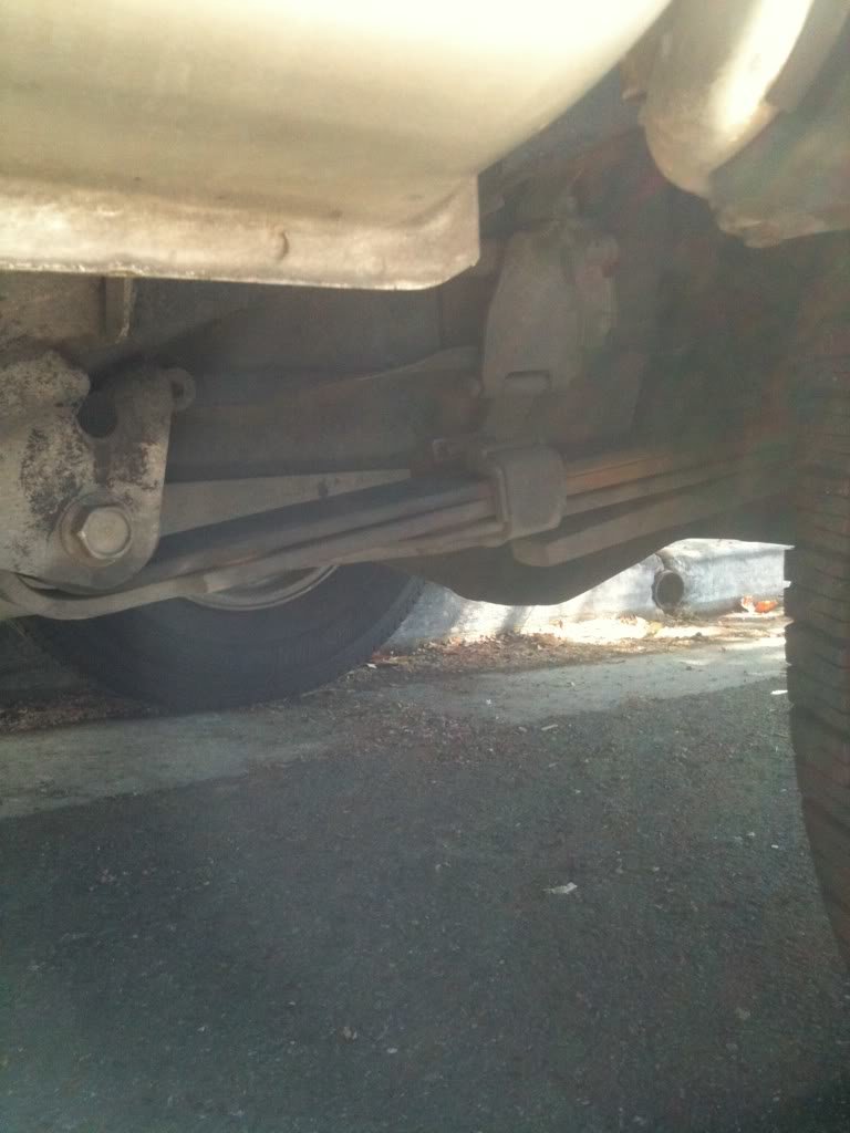

    Ok so having this set up with an AAL (2") should level out right?
    Also i have some sagging on my existing leafs... would the AAL help?
    Thanks

    if they are frowning, then they are shot! an AAL will only bandage the saggy stock leaf pack, your best bet would be to get a whole new leaf pack if the funds allow and if not do like ive done in the past and will do on my truck and re-build your lstock leafs using leafs from another leaf pack...i helped trd7 re-build his and we spent under $5 doing it

  11. Sep 20, 2011 at 12:07 PM
    #131
    Alpha Q Up
    Alpha Q Up Well-Known Member
    Aug 18, 2011
    #61921
    2,325
    Ruben
    San Jose
    2003 4WD DC Tacoma
    Hers is a pic... Does this look like frowning?

    Yea i realize that will make a difference but would it be that big of a difference? and im sure they have settled but others have settled as well and they still sit around 3"...im gonna take em off sometime soon and see if maybe the isolator is fuggerd up since i didnt replace that wen i originally put the coils on and maybe I did something wrong when i seated the coils....Ill find out
    Yes they are deffinatly frowning.

    So What exactly does "bandage" do when AAL?
    haha i don't think i can do $450 on rear leafs. And i dont have the capability to rebuild an oem replacement. *crap

    it will temporarily fix them untill the AAL starts to sag as well, and the expos are only 359 or something like that.. but re-building them is very simple..took us about an hour and a half and that included running to the parts store. Im sure someone on here would be willing to help you out for a case of beer or something
