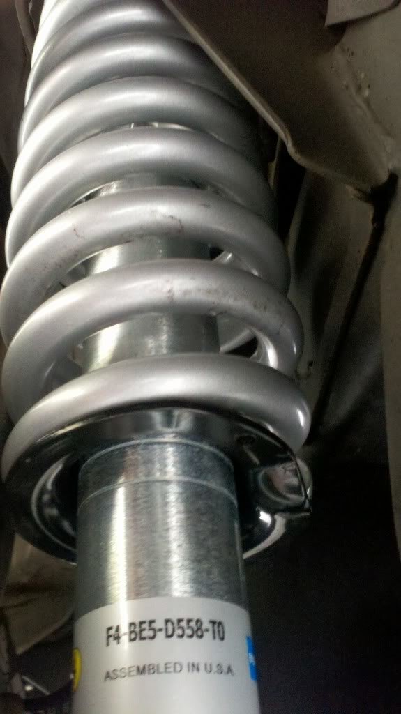

    PcBuilder14
    PcBuilder14 Well-Known Member
    Jun 19, 2011
    #58522
    23,311
    Brent
    Nor Cal
    2018 Tacoma TRD Off Road 4x4
    More pics....
    The Bilsteins showing their face.... :)
    Random
