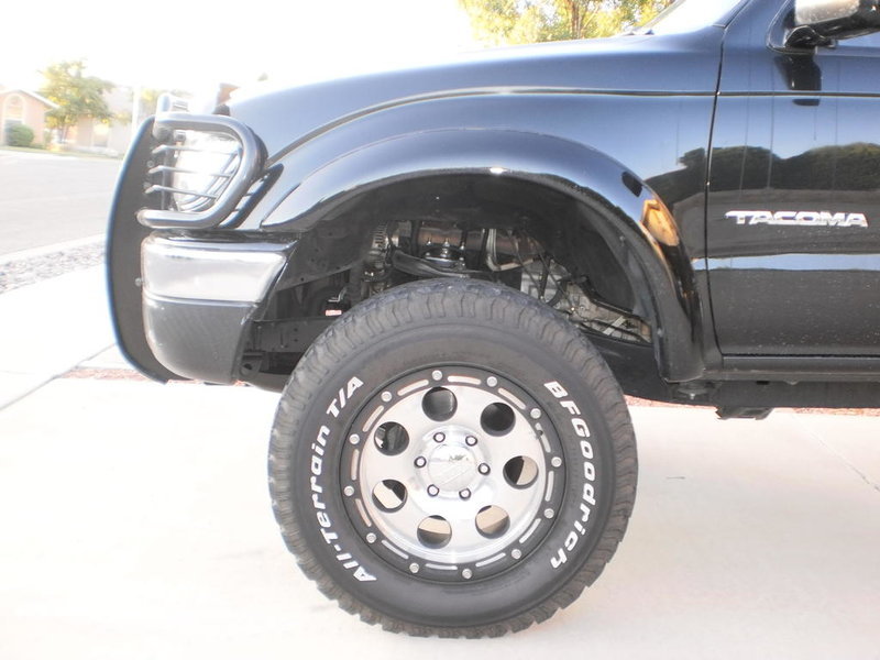

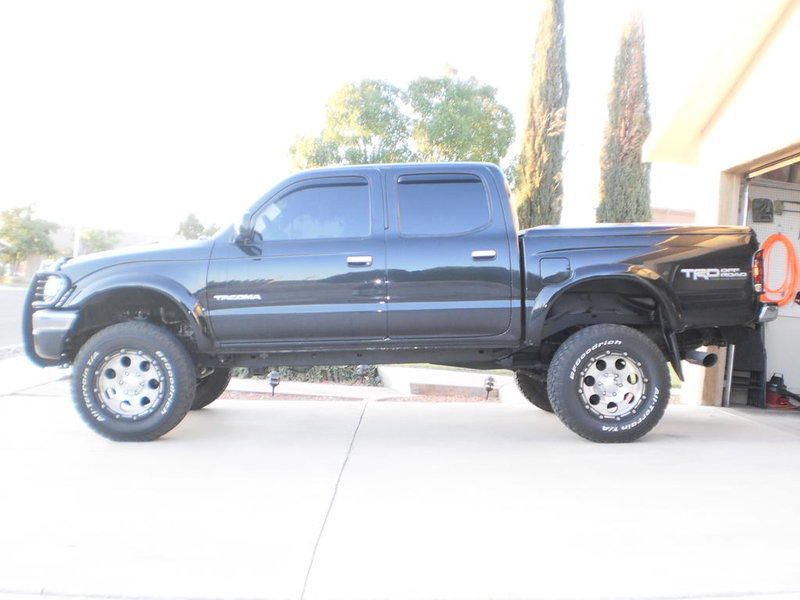

    ok guys so ive been looking at doing this for a while. right now i have a leveling spacer from fatbobs garadge in the front and 2in blocksin the back. Oh and the bilstein 5100 all the way arround. The rear leafs are frowning so i fliped the thick overload leaf at the bottom to help support the spring. so doing that gave me some rake in the back around 3 in. So my question is will adding the eibach coils up front bring me back to about level. ill post a pic here in a bit of how it sits now.

    Here are some pics also i forgot to metion that i have 2in body lift on there too.
    the measurment on the back is 27 1/2 in
    the front is 24 1/2 in
    this is measured from center hub to fender.

    id like to do that but i cant afford to do them both. for now i can live with the leafs as they are cuz i would like to get the front leveled out first.

    That's what my front measured today, so 24 1/2" plus your 2" body lift would be 26 1/2", your back would only be 1" higher (not too bad, just throw a few sand bags in the bed)

    No those measurments are including the body lift. so with no body lift the front would be at 22 1/2. im dealing with a 3in difference from the front to the back (back being taller).

    You would get 3+ for the front, so the eibachs would level you out :thumbsup:

    I know, I'm saying that with Eibachs, you would measure close to 26 1/2" in the front (with body lift, and 24 1/2" without) your rear is 27 1/2" (with) and would measure 25 1/2" (without)

    I would get it realigned. It won't be exact, but close enough.

    How's the ride with those overload leafs flipped, isn't it kinda harsh? I've read where others have ended up having broken leafs after flipping the overload. If you don't offroad it much, you might be OK. I would think that you eliminated most of the flex in back.
