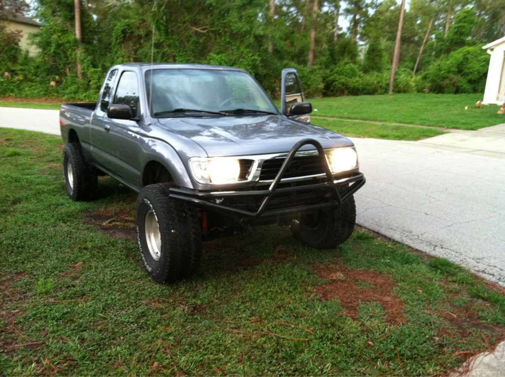

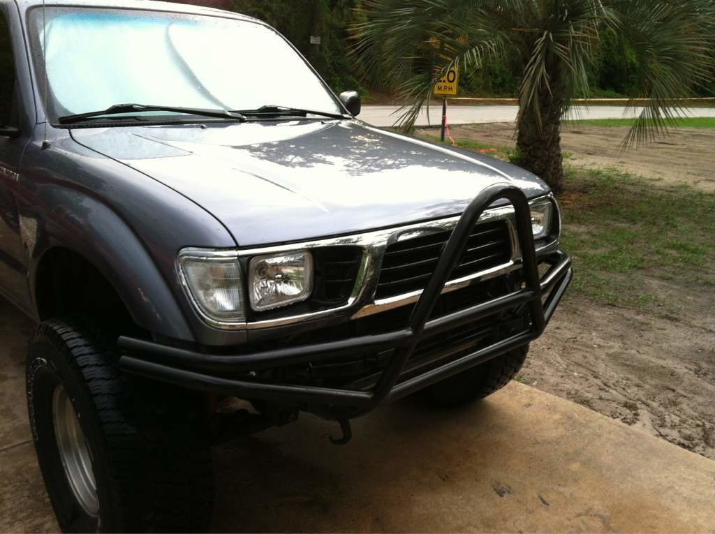

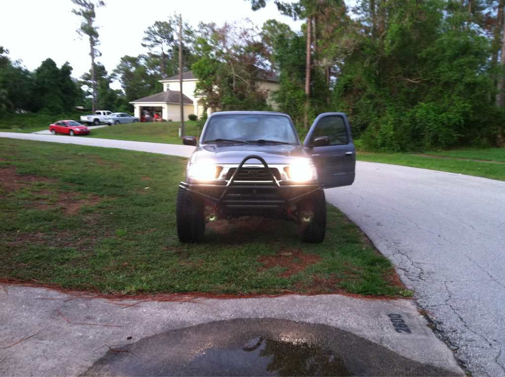

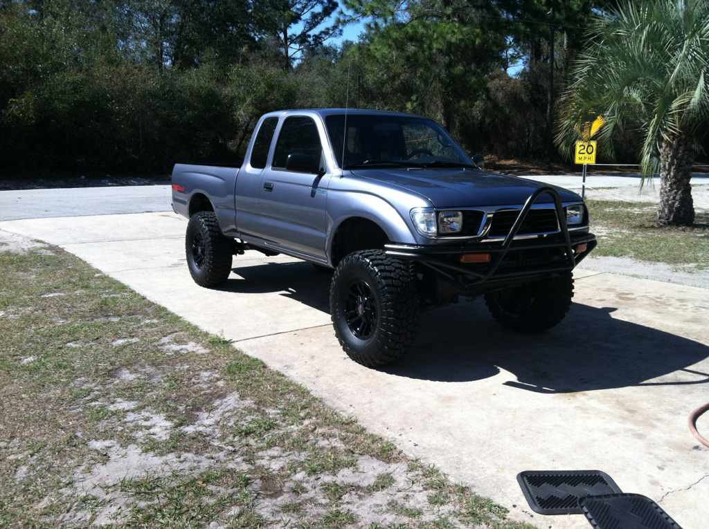

    I have eibach coils on my racerunner 2.0's, and I have rear 5100's :anonymous:
    so here is my tewb bumper. But they dont make it anymore. :anonymous:
