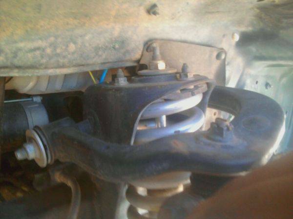

    Alright, peeps, I would like some advice...
    I'm thinking about moving my 5100s up one notch (currently on bottom), to gain some more lift and cornering stability. I know you're typically not supposed to do that with eibachs and 5100s since they already handle weight very well, but mine are getting older and having to support more weight. When I first installed my lift, my truck was basically stock and 2wd... I have since added a lot of weight (4wd conversion, tube bumper, 1/4 skid plates, maybe a winch in the future), and want to see the height it used to be at. Right now, my UCAs are pretty much level, and I know they used to be at more of an angle. Also, I hit the front bump-stops too much for my liking, off-road, and my body roll is pretty extreme right now and would like to get that a bit more stable. (It scares my passengers! lol :D)
    Of course I don't want to lift the front end too high to where a good alignment isn't attainable, and while my manual hubs help keep the CV boots intact during daily driving, (even if the ribs touch) I don't want to push the lift over about 3.5". My current hub-to-fender measurement in the front is about 25." Considering I took 2"out of the fender, that puts me at 23" hub to bottom of stock fender.
    Does anyone have the stock measurements by any chance?? Or even they're current measurement with eibachs/5100s? That's what'll help me decide whether or not my eibachs need a bit more preload.. Thanks!

    Your UCAs are level with your coil buckets????
    How??
    Mine aren't and i have just as much if not more weight..

    I should have emphasized that the first pictures I uploaded were prior to alignment, my toe was way off. Here are pictures before and after.
    1.)Before Alignment
    2.)After Alignment
    I have noticed that many with LR UCA have a angle and did notice mine were relatively level. I starting thinking I put the UCA's in backwards.

    No, just level with the ground. :notsure:. Regardless... my hub to fender measurement seems to be a good 1"-1 1/4" lower than everyone elses...

    Granted, they hadn't quite broken in yet, but here's what my UCAs looked like when I first installed the lift.

    Alot of the level alignment with my UCA's comes from the new ball joints that came with the LR UCA's. I did some research and a level UCA is optimum.
