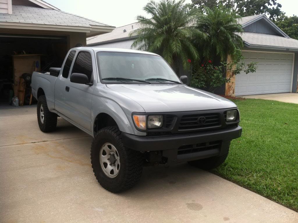

    Finally pulled the trigger on my 5100/eibach set. I'll put pics up when it's all on!
  11. Jul 25, 2013 at 10:29 AM
    #1711
    Gear Head
    Gear Head Well-Known Member
    Oct 27, 2012
    #89921
    4,630
    Jacob
    Winston Salem, NC
    96 Tacoma
    fj60 front, fj80 rear, full hydro, 5.29's, welded, twin sticked 2.28/4.70 duals, 39.5's, inboarded 63's

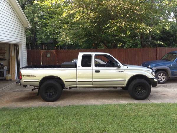

    Lift installed.
    Before:
    After:

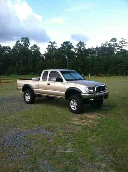

    My truck with the bilsteins 5100's and eibach's in the front and a 2 inch aal in the back. Hoping to get se 33's soon!ImageUploadedByTapatalk1374780895.401488.jpg

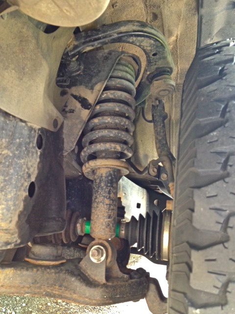

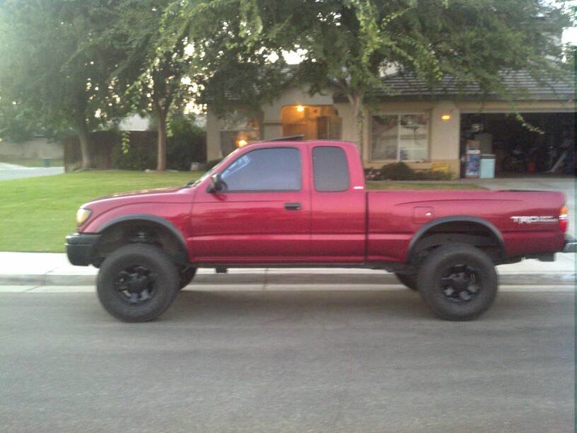

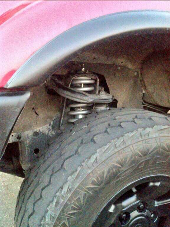

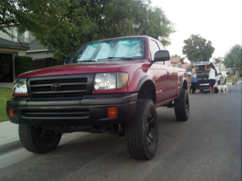

    Oh yeah, here are a few pics of my rig:
    Side View:
    Front:
    Front Suspension:
    Rear:

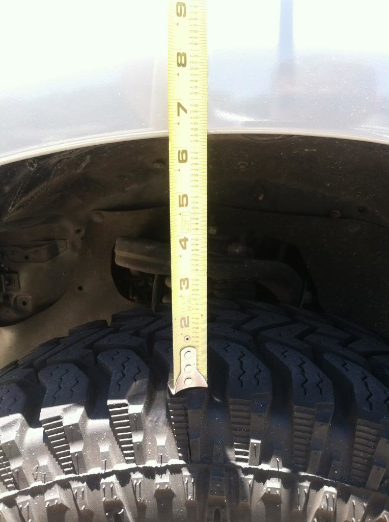

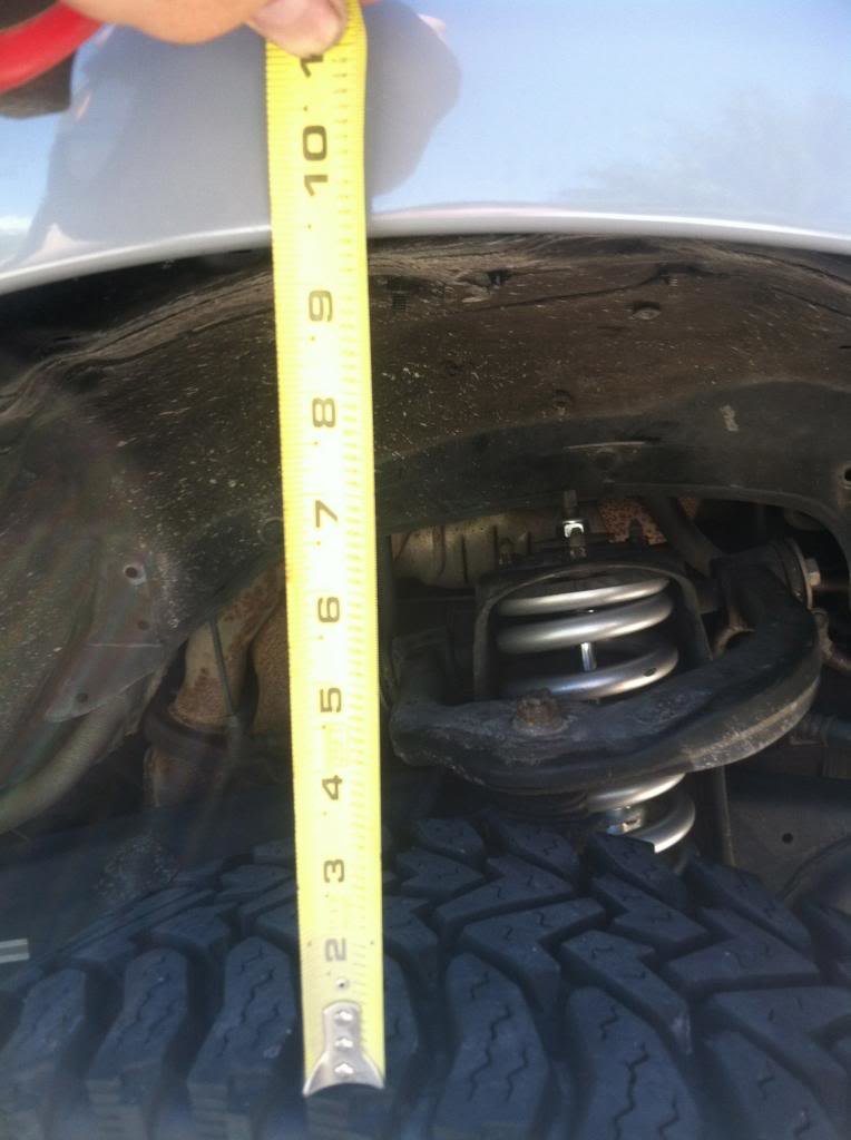

    Can anyone tell me how many inches they get from the center of the hub and the top of the wheel well with 5100 and eibachs?

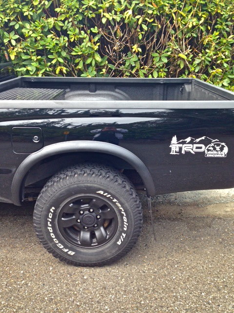

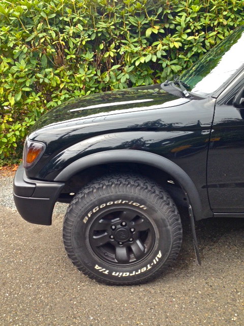

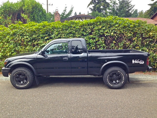

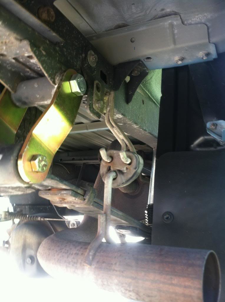

    installed mine about a week ago and just got around to taking pictures
    the rear has about 2.5" lift. spring refurbishment by A1 Spring Supply
    and on stock 31x10.5x15 with spidertrax wheel spacers :D
