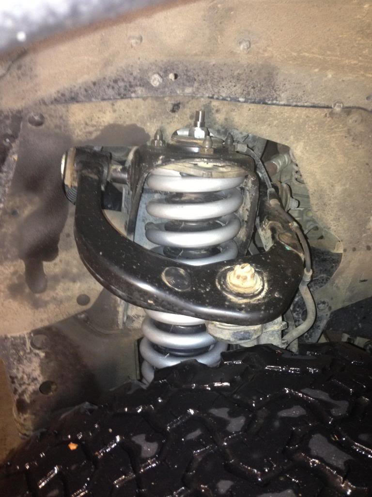

  12. Aug 14, 2013 at 5:17 PM
    #1752
    Konaborne
    Konaborne Pineapples on pizza Hawaiian does not it make.
    Nov 21, 2010
    #46536
    31,906
    Cody
    Kealakekua, Hawaii
    Lifted 00 TRD Off-Road
    fox extended travel remote resivoir coilovers, 14" eibach 600lb coils, All Pro tubular chromoly 1" uniball upper control arms, All Pro expedition leaf packs, 10" bilstein 5150 piggyback reservoir shocks 265/75r16 Goodyear wrangler MT/R kevlars wrapped around 16" Helo 791 gloss black, Mini H1 retrofits with 6000k bulbs, 18" magnaflow w/custom exhaust reroute various decals, Sockmonkey retro hood stripes
    Are you missing a washer under the UCA bolt, between the bolt and the uniball cup? Or can I just not see it in the pic
  13. Aug 14, 2013 at 5:58 PM
    #1753
    tc98tacoma
    tc98tacoma Well-Known Member
    Nov 5, 2010
    #45752
    4,219
    Nik
    San Antonio, Texas
    98tacoma4x4
    3inch toytec coils 5100's, aal(soon to be replaced), 33/12.5 km2s, + a money hole...
    I don't think so? That little gray clip??

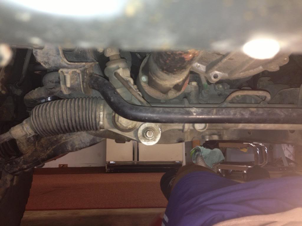

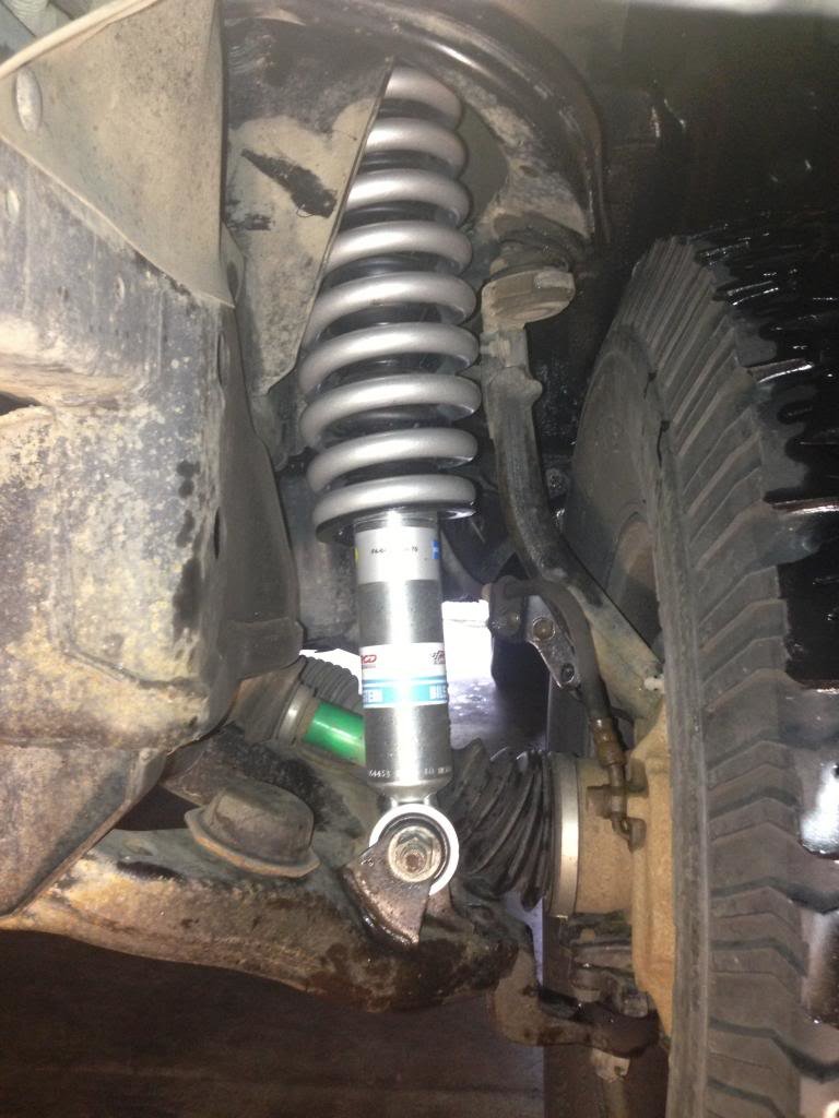

    Front Diff Drop Help
    The Eibach Coils/5100s Side View:
    The Eibach Coils/5100s Front View:
    My question is in the following picture is this where I take out the bolts and add the new screws/pucks for the front diff drop kit?
    I'm concerned because in the rear there is only about 1" or so of clearance between my drive line and the front diff...
    :confused:
  15. Aug 15, 2013 at 4:54 PM
    #1755
    Gear Head
    Gear Head Well-Known Member
    Oct 27, 2012
    #89921
    4,630
    Jacob
    Winston Salem, NC
    96 Tacoma
    fj60 front, fj80 rear, full hydro, 5.29's, welded, twin sticked 2.28/4.70 duals, 39.5's, inboarded 63's
    Yes that's where you install it. And the low clearance right there doesn't matter. A diff drop doesn't actually drop whole diff. All it does is rotate the front part down.
  16. Aug 15, 2013 at 5:11 PM
    #1756
    yote
    yote Washington State University
    Jul 25, 2012
    #83444
    4,634
    Mark
    Tacoma, WA
    2002 Ext Cab TRD Off-Road
    Ahhhh excellent, thank you for the speedy reply!
  17. Aug 15, 2013 at 5:21 PM
    #1757
    Gear Head
    Oct 27, 2012
    #89921
    4,630
    Jacob
    Winston Salem, NC
    96 Tacoma
    Yeah man! Take before and after pics of your cv angles. I'm debating as to whether or not to pick one up. Also I'm having a vibration between 10-20 mph and think this might be the culprit since I've already dropped the carrier bearing.
  18. Aug 15, 2013 at 6:02 PM
    #1758
    taco47001
    taco47001 Newborn
    May 11, 2012
    #78644
    1,912
    Aurora, IN
    LX470
    It looks like you have the 5100's coil perch set at the 2nd setting...:eek: With Eibach's they have to be on the 1st....this is why your CV's are screaming at all of us...
  19. Aug 15, 2013 at 6:05 PM
    #1759
    Gear Head
    Oct 27, 2012
    #89921
    4,630
    Jacob
    Winston Salem, NC
    96 Tacoma
    Oh shit! Good look!
    Yeah dude, I hate to say it but you gotta take those back off and move that snap ring all the way down. Your cv's and upper ball joints will be destroyed like it is.
  20. Aug 15, 2013 at 6:51 PM
    #1760
    yote
    Jul 25, 2012
    #83444
    4,634
    Mark
    Tacoma, WA
    Already one step ahead of you though with the discovery that it's on the 2nd setting :eek: I'll take more before pictures after I get this all taken care of..
    Oh shit! Good look!! I had a shop seat the coils/shocks so this is what I get for taking the lazy way :(
