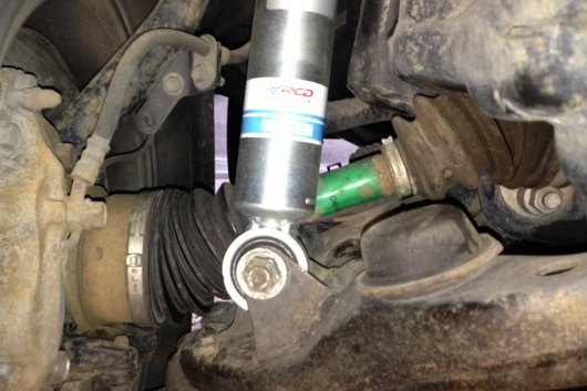

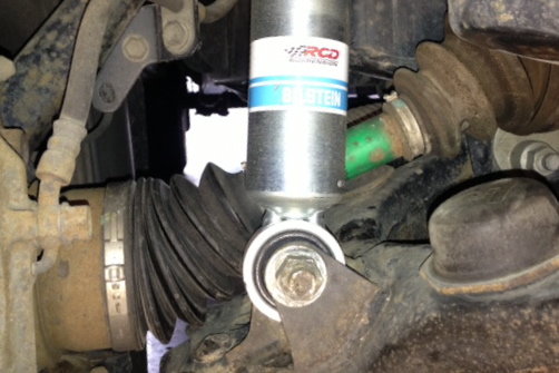

    Here's those before & after pics for you Jacob:
    Passenger side CV joint angle before:
    Passenger side CV joint angle after:

    Your bilstein 5100s should be set at 0", or stock. They are there merely to cushion the ride. The actual lifting (of 3") will be done by your Toytec/Eibach coils

    Mine came shipped with the snap ring on the highest setting. Make sure you move it all the way down. This will give you the lift you're looking for. Anything higher and you're going to damage parts. Tacoma IFS can only handle 3" of so or lift without a drop bracket.

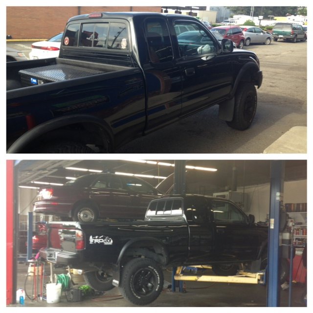

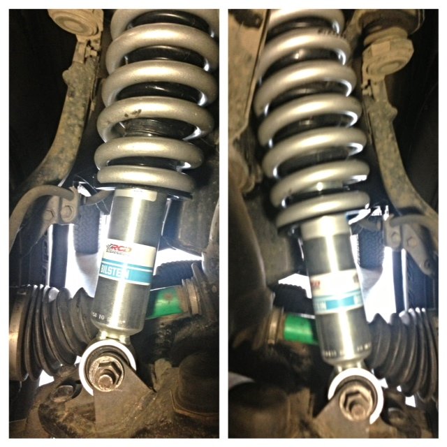

    The ride is A LOT better than it was before. Here are the CVs and the coils/shocks. Those are where they should be now, correct? I think so but it's always reassuring to have a 2nd opinion :)
    Now he said he had them on the highest setting :eek: but when measuring before/after this is what it looks like from the ground up the center to the (middle of the) fender flare:
    Stock
    FD - 34.25"
    FP - 34.50-34.75"
    RD - 35.50"
    RP - 35.25"
    After Front Install (at 2.50") w/ Coils
    FD - 39.50"
    FP - 39.25"
    RD - 36.00"
    RP - 35.50"
    After Fron Install of shocks to 0" w/ Coils
    FD - 38.50"
    FP - 39.00"
    RD - 35.50"
    RP - 35.50"
    I feel like I would've had more drop after he lowered the bilstein shocks down to the stock level :confused:
    Like I said, the ride is a hell of a lot better and looking at it, the struts look like they're on the stock setting and the coil is DEFINITELY doing it's job by adding about 4" of lift -- which will probably settle to around 3"

    That looks a lot better. And as far as the numbers with the 5100's at the highest setting with the eibachs you were probably maxing the control arms (full extension) and they were limiting the amount of lift you actually got. I'll go measure mine in a sec just to compare.
