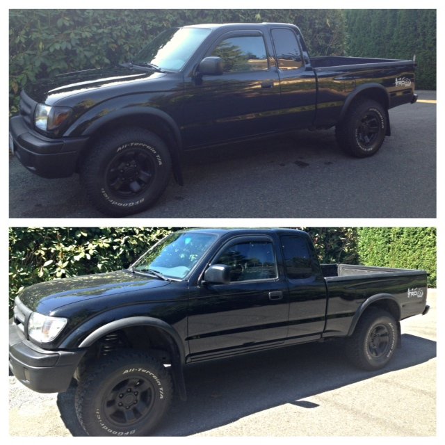

    Oh yeah and a picture of the stock suspension (top) and then the Eibach/5100s up front (bottom):

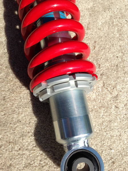

    Ok, now I'm confused...I guess I got something slightly different than those previous pictures. Mine arrived today and the have threads for adjusting, not a movable ring.

    Those are adjustable coilovers. You can thread the rings up or down to set the ride height where you want it. We all have the regular 5100 struts which have snap rings.

    Ah..ok thanks. Are these adjustable while mounted? I'm guessing so.

    Stock rear ? No lift?

    Yes stock rear. Currently waiting on my Expo leafs to come in and ship

    Yeah they should have come with a spanner wrench

    Would you mind getting a picture if the rear like directly facing the wheel...
    Just seeing if I could possibly fit my 33/12.50s with my AAL or only maybe an inch of lift in the rear...honestly thinking about going back to stock completely;/
