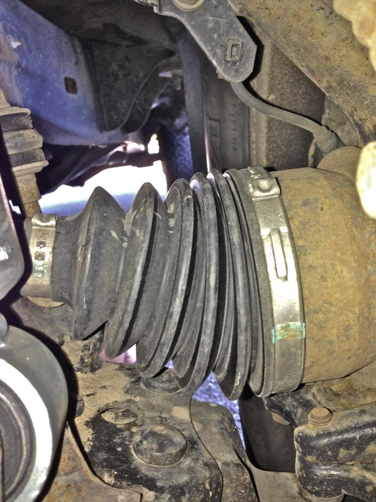

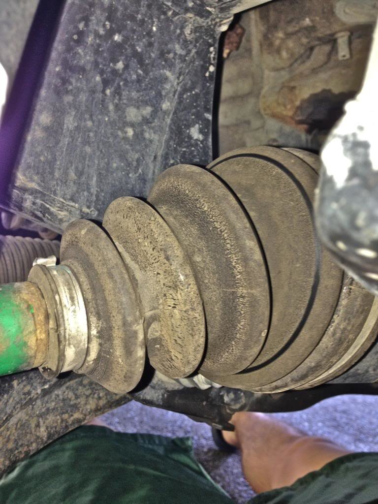

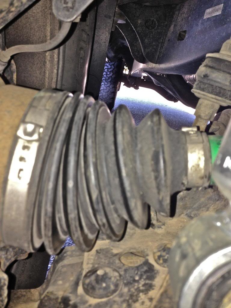

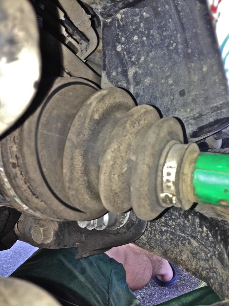

    Okay one more question, are my CV boots be a concern? I feel like they're a little bit scrunched than my liking -- particularly the lower boots on both sides...
    Passenger Side Lower Boot:
    Passenger Side Upper Boot:
    Driver Side Lower Boot:
    Driver Side Upper Boot:
  16. Aug 21, 2013 at 6:22 PM
    #1836
    Gear Head
    Gear Head Well-Known Member
    Oct 27, 2012
    #89921
    4,630
    Jacob
    Winston Salem, NC
    96 Tacoma
    fj60 front, fj80 rear, full hydro, 5.29's, welded, twin sticked 2.28/4.70 duals, 39.5's, inboarded 63's
    The rings around the boots where the boots are clean is due to rubbing. Eventually it will wear through the boot. Do the boot slide mod. It's cheap and easy. Mine aren't rubbing and I'm still going to do it, just need to get another hose clamp.
  17. Aug 21, 2013 at 7:05 PM
    #1837
    yote
    yote Washington State University
    Jul 25, 2012
    #83444
    4,633
    Mark
    Tacoma, WA
    2002 Ext Cab TRD Off-Road
    Yeah that's what I was afraid of. I'm just glad I caught it now and not when it tore and started leaking shit
    So this mod:
    http://www.tacomaworld.com/forum/2nd-gen-tacomas/190669-my-cv-boot-mod.html
    orrr this one:
    http://www.tacomaworld.com/forum/1st-gen-tacomas/146070-boot-slide-mod-no-more-blowing-cv-boots.html

  19. Aug 22, 2013 at 1:09 PM
    #1839
    yote
    Jul 25, 2012
    #83444
    4,633
    Mark
    Tacoma, WA
    I'm having a hell of a time getting the lower boot to slide up the shaft 1/2" or however far will allow the fins not to rub... it just can't get past the groove-- wiggles about 1/16-1/8" up the shaft and won't go any further. I'm wondering if this is meant for 2nd gens (since it's in their section) or what :confused:
    I have PT here soon so I guess I'll throw a clamp on the lower boot and put everything back on until further notice :(
  20. Aug 22, 2013 at 1:22 PM
    #1840
    taco47001
    taco47001 Newborn
    May 11, 2012
    #78644
    1,907
    Aurora, IN
    LX470
    Slide a small flat head under the lip and work it around, simultaneously working the boot down with your other hand....it'll go.
