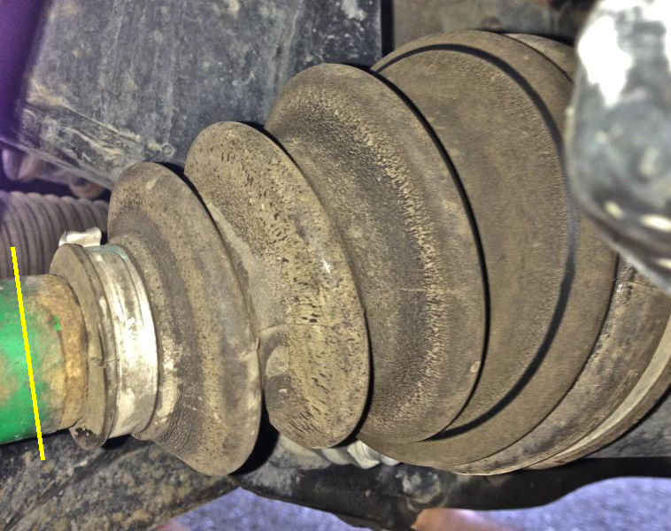

    Slide the boot down? ... toward the tire (with the lower boot)?
    Should it go up the shaft toward the upper boot to stretch the fins and prevent touching?

    Leave the lower or outer boot alone. The issues on a 1st gen are with the inner boot ONLY.
    Now, just sliding the boot and re-clamping is the "I don't have the time to do it right" or "just temporary till I can do it right" method. The procedure can sorta work, some of the time but there are issues. Doing it as a temp measure will be fine but be aware that once a moderate groove is worn into the boot it will be just a matter of time till it fails. The rub mark on yours looks OK, for now.
    There are 2 issues with the "quick slide".
    1st, the clamp must be tightened to the point of causing trauma to the boot and or cutting of the boot by the clamp edge.
    2nd, the clamped area of the boot must be slid all the way past the edge of the groove to have any chance of staying put. With that much "slide" the "valleys" between the finns are stretched to much and can tear over time.
    For the finns not to touch, only requires about 1/4"-3/8" of silde. More is not better in this case. The yellow line below is as far as it needs to go.
    Using an internal stop allows the area under the clamp to sit on the edge of the groove. It can not slip back and the boot will stay happy until it rots away.
    If you take the short cut it keep an eye on it. If you do it right then you can forget about it.
    How ever you go, peel off the label and clean clean clean then dry dry dry the shaft.

    Ive blown both inner and outers, it's helpful to do both boots
    also gotta watch how far you stretch the boot, too far and it'll tear when drooped

    The lower boot seems to definitely be rubbing fins as well though...
    I'll take a look at this situation when I get home from PT and will do the upper boots.
    Did your lower boot slide easily? I couldn't get it to slide AT ALL. I see the fins are touching so I know this is no bueno for my boot(s)

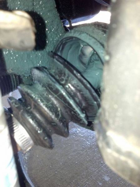

    wore through on the outer, tore the boot right open

    there's a seal on the boot end from the clamp and the grease, you gotta take something like a small flat head screwdriver and wedge it into the boot (being careful not to tear it) to break the seal, then pull the boot a bit
    it helps to clean the CV shaft beforehand too

    I'm :confused:, that is an inner and IMO it probably tore because it was slid to far combined with to much lift. A bunch of folks have had that happen. Zero failures when an internal stop is used. You got to re-boot now anyway, try it.

    I've blown 5 boots, one was an outer. trying to find the pic, but I cant go through my entire gallery since I'm a work
    I cycled the front after I slid it down to check for slippage and to check if I slid it down too far; it was fine, slid it less than a half inch to get the boot out of the way
    But it was already pretty worn, was kinda just a matter of time.
    I'm gonna try the internal stop the next time I blow a boot. ended up swapping the entire CV because of diff seal problems
