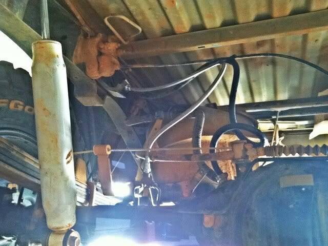

    I got mine from allpro, was cheapest after shipping that I could find but my spares are trailgear, youll want an extended braided line
    Will look like this
    & installed

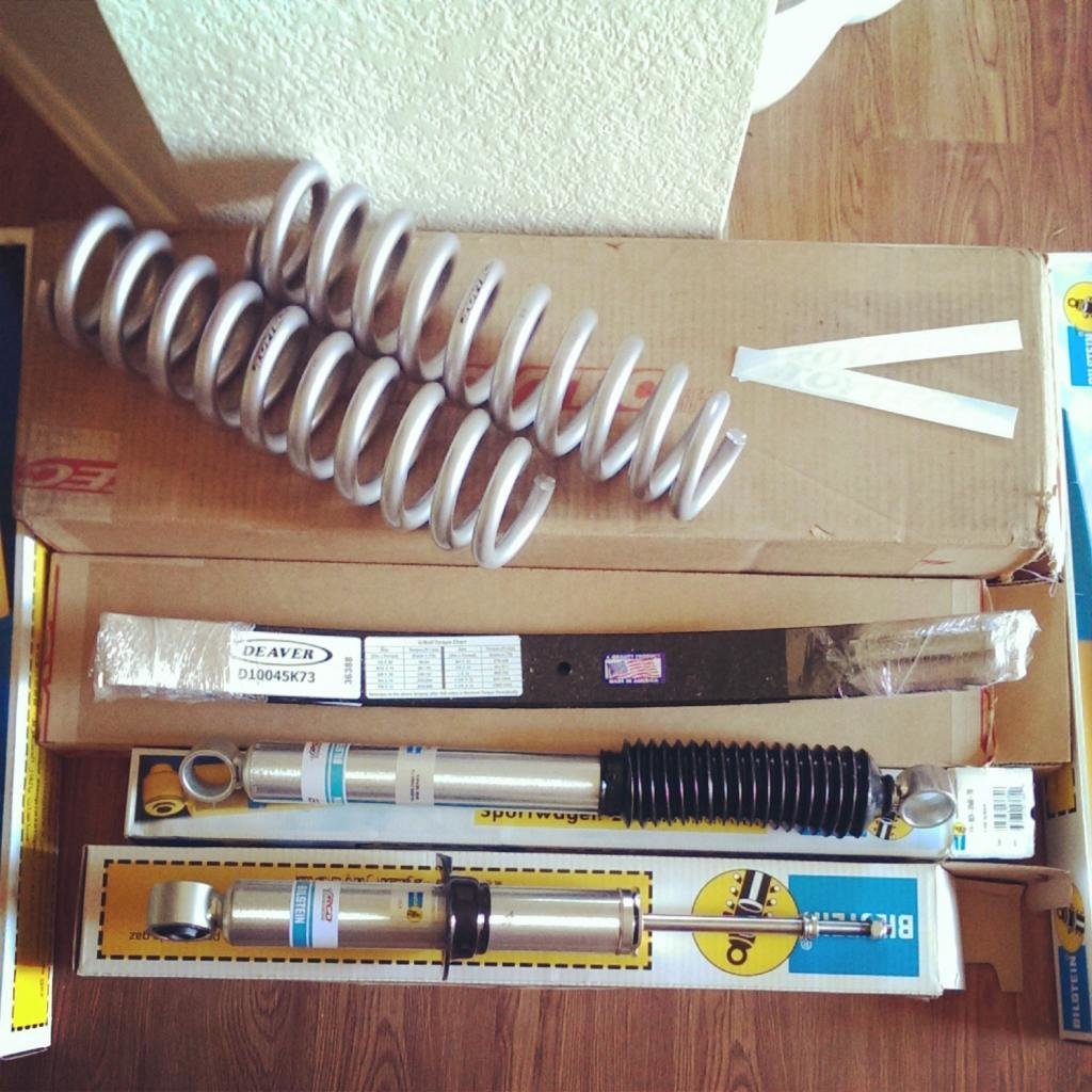

    sorry in advance i know you guys have touched on this before because ive seen it but cant seem to find it again! getting some goodies installed that showed up on my doorstep today!! IMG_20130928_140318_aa3d6116c05a6dc4576f5f7e9462199c8adab6bd.jpg
    and i forgot which setting will provide with with the best ride? "0" "1.25" or "2.50"... pretty sure i remember someone saying the lowest setting? thanks guys! cant wait to be part of the 5100/eibach club :D

    The lowest setting will give you more that 3" of lift putting you beyond the design spec for the Tacoma IFS. Going higher than the lowest setting is definitely not recommended.

    0" is the ONLY setting for 1st gens.
    Unless your coils are shot and you have some super heavy weight up front then MAYBE you can do 1.25"(Silas is the only one i know that has needed to do that)
    You have no bumper or anything so 0" will be MORE then enough anything higher and you'll destroy your CV axles.

    alright cool, thats what i thought. they came preset to for the top setting so ill move the ring down. thanks!
    Sweet sounds good :) thanks for the quick reply!! just wanted to make sure before i start the install tomorrow morning! cheers! :drunk:

    To avoid confusion (like I had) the lowest setting is the bottom setting when the nut/ threads are at the top. Also make sure the coil seat is on correctly, it should cover the "C" clip completely. After researching and going through the install my self, I've seen people mix up the top setting for the lowest, and an upside down coil seat will gain you extra preload that could ruin your setup. If you have it installed make sure you know how it should be so you can check their work. Have fun with the new lift!
