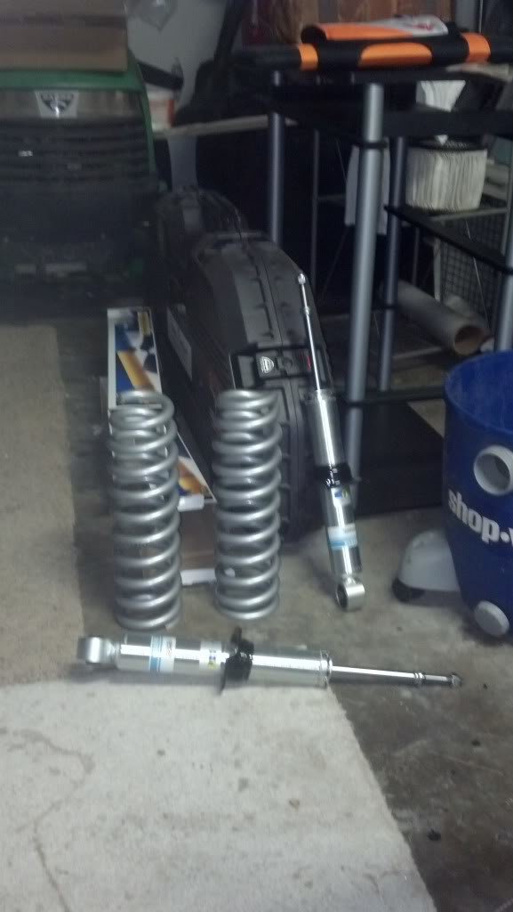

    These came yesterday!

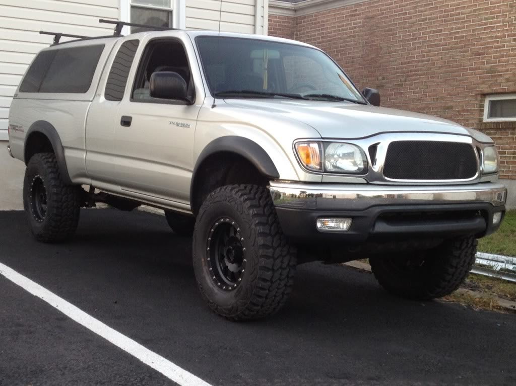

    I remembered when mine shined like that :/
