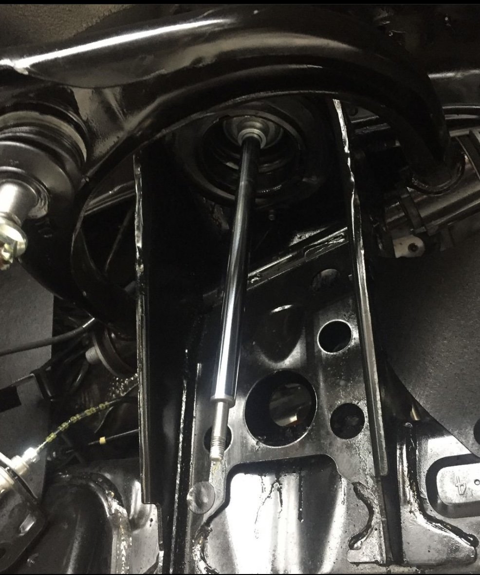

    Any of you gentlemen seen this one? Shock unscrewed from lower mount. Contacted Bilstein and received only finger pointing (at me) and blame assignment (again at me). Note the shock appears wet because I had just sprayed everything down with Kroil, and the photo with the threaded end way up in the air is because I had a jack beneath the differential. Any thoughts or fix ideas appreciated. Bilstein ultimately told me to Loktite the threaded end back into the mount.
    Bilstein 5100 shocks coupled with OME Dakar CS046 springs.

    Yes the shock probably wasn’t assembled correctly. However I’d be surprised if Bilstein accepted responsibility.

    Oh trust me, Jose Trieu at Bilstein (ThyssenKrupp) blamed me for a lift kit? WTF? I then sent pics of my Dakar springs on my rig and he said the springs are flat and obviously worn out. Appalling customer service and I'm looking at alternates.

    just because springs are flat doesn't mean they are worn out. my new truck came with flat springs from Toyota.

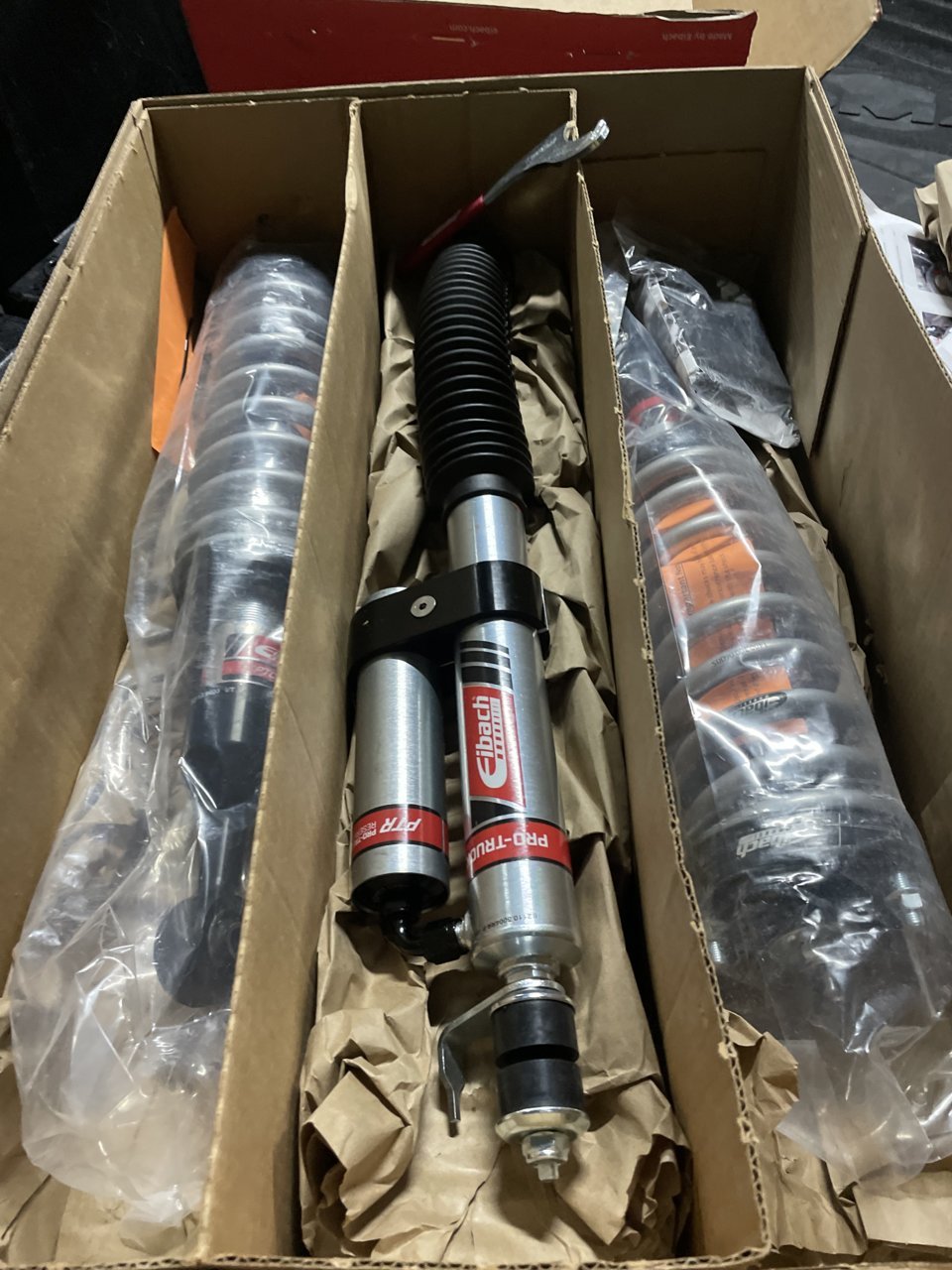

    Here is my stage 2 r Eibach. Don’t intend to do any radical off-roading. Just 285 70 17. They suit my purpose F1CD67AD-6E4D-4CA1-B6BC-BA1123AC2031.jpgAD8E8B40-4F3B-409F-B536-E7E6882B08B2.jpg 34719446-13B0-4559-9B02-4193AAA0F1C2.jpg

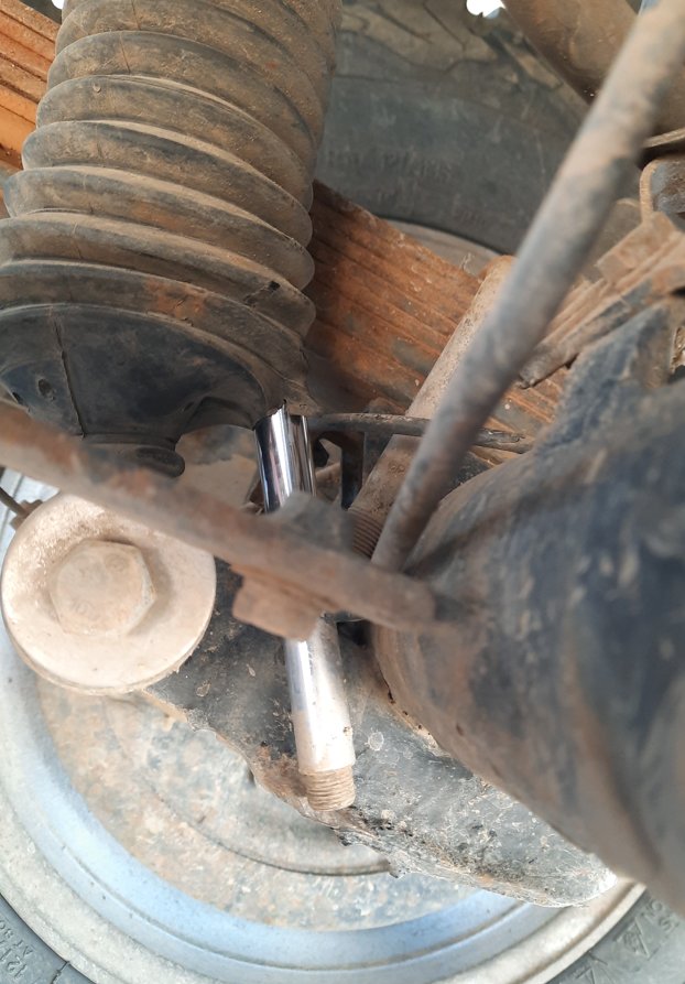

    Few years back - had about 500 miles on it

    I’m guessing this happened because your shocks were being used as limit straps.

    his? Or mine?
    I honestly think mine was defective

    the op
