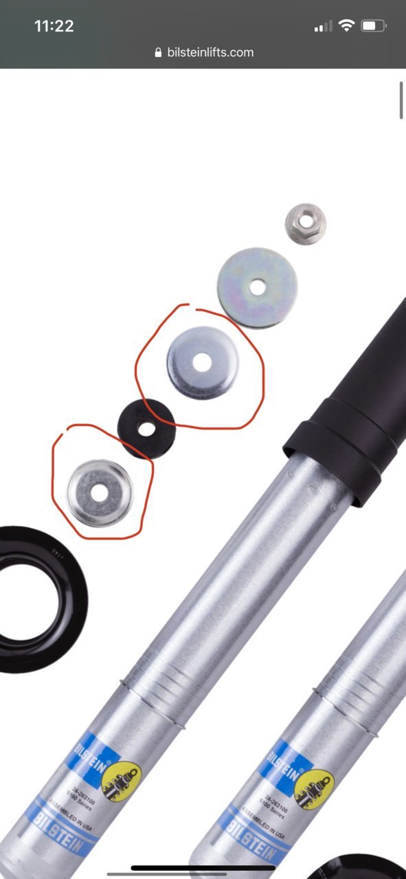

    I think I got the washers reversed. Is this going to affect it?
    Edit: they’re already installed facing the correct direction but reversed

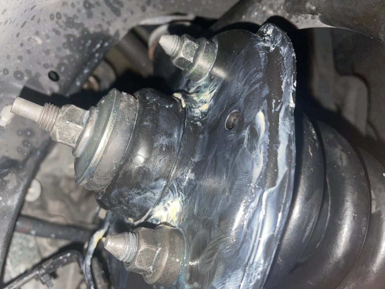

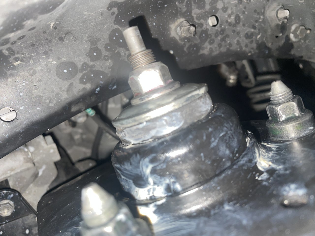

    Here’s a picture. Maybe I have them on right? I think the lower is shiny and these are dull. Maybe you can tell by the picture..

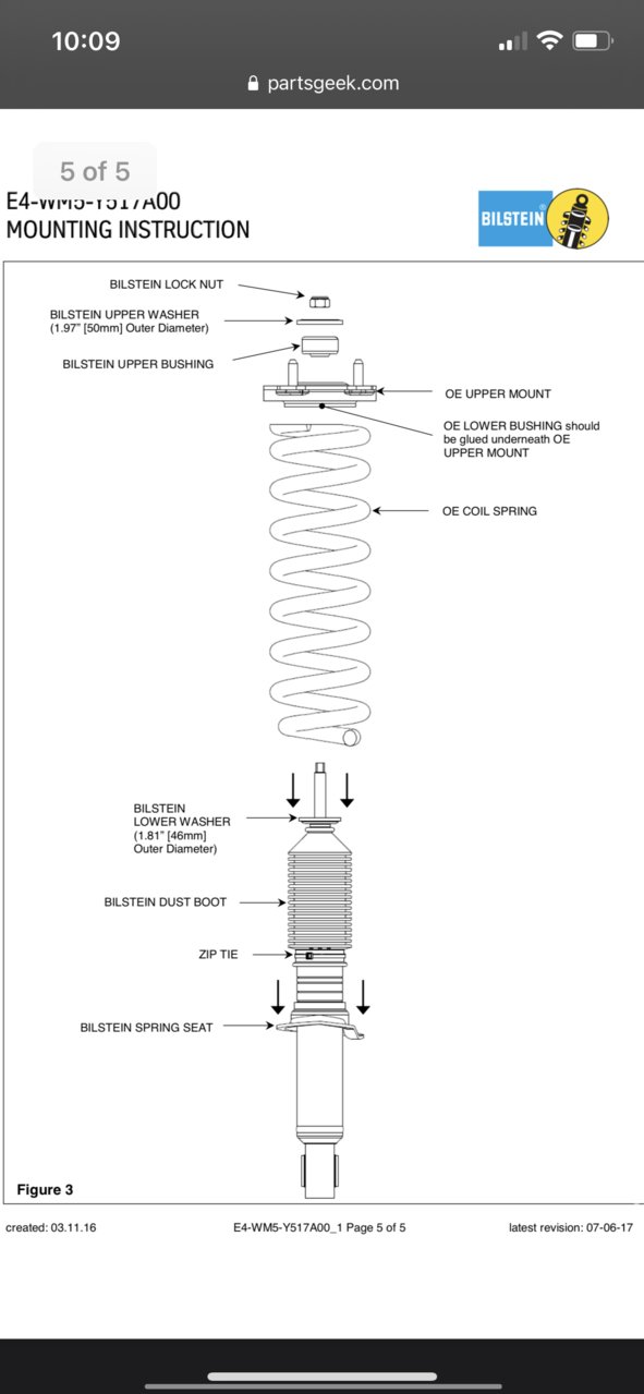

    There's about 0.16" difference (about 3/16" difference) between the two. That's not much for that particular application but then why did Bilstein choose to not make them the same?
    If it is backwards, at least find/purchase some of the larger diameter washers for the top. That would be an easier fix.

    This is the hardware.

    That looks fine to me. The washers for the fronts were the same on mine. Yours might have come from two different manufacturing lots.

    What I'm saying is to take a caliper (measuring device) and measure the diameter of the installed washer to prove that the larger diameter washers are on top. If not, just obtain some more larger washers for the top. Wouldn't that be an easier job than completely disassembling the entire shock?

    I measured it with a caliper this afternoon, and yes they are reversed. The 46 up top and the 50 on bottom.
