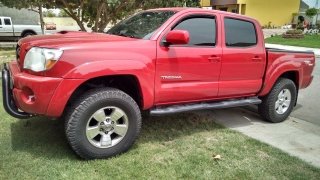

    I have my taco with the front Bilstein 5100's at 2.5 in of lift, with the stock spring, and the 285/70/R17 and I have to install wheel spacers at 1.25in to avoid rubbing the uca, but need a little trim in the rear of the fender flares, at this point I haven't done yet, because of work.
    I forgot to mention I have the stock rear suspension, in the near future I will install aal at 1.5 in I guess...

    Looks good from what I can tell of this angle. Are the spacers due to the 285 tire? I'm gonna be running 265's for now. With that much of a front lift + stock rear, it doesn't feel/look weird - hard to accurately tell from this angle

    yes the spacers was because the 285,
