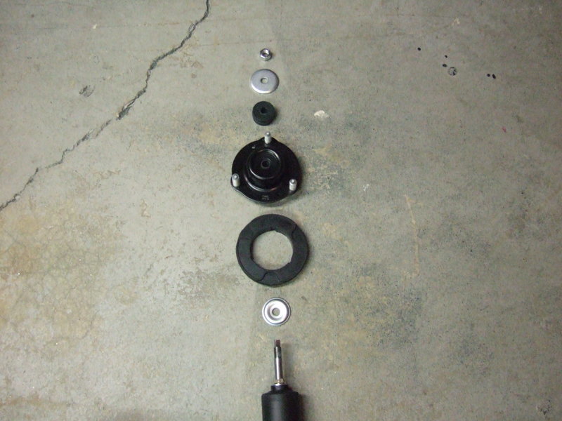

    There is not separate bushing under the hat, it's part of the hat itself, just a washer, check the pic that was posted on first page with it disassembled

    Here is a pick of all the washers and bushings:

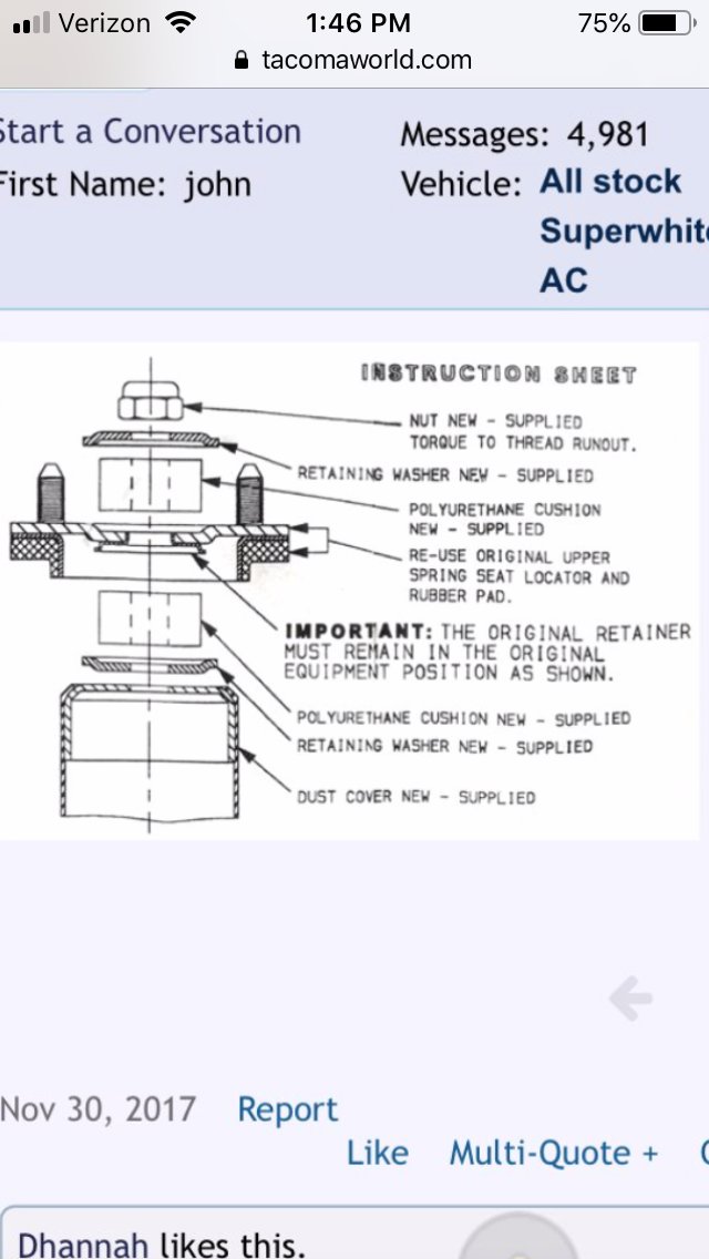

    something got to be wrong with that stud/washer/bushing arrangement for the threaded stud to run out of threads before the bushing is squished, from what I read in those threads I posted which has the same exact issue and were also using the 5100's is that the bushing under the hat fails due to the overloading of it using the adjustable height rings on the 5100's and need to be replaced either with a new hat assembly or the use of the WHEELERS replacement bushings upper and lower bushings and washers, the bottom bushing is replacable and the only new replacement would the the WHEELERS or pay for the complete hat with the bushing already in it.

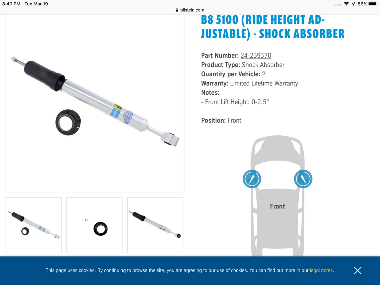

    OP i can tell you something is wrong. You say the boot is installed correctly but i see shock shaft.
    What 5100 part number did you order.

    This pic is shows different parts here, there is not a bushing on the bottom like that pic shows. Also, that pic says that those bushings and pieces are “ supplied “ which all I got was the struts and nuts.

    Mag gry...the struts I got had the boots already on and had the top nuts, there was nothing else with it.and no where can I find, nor the instructions, where guys specifically install that boot, they just assemble the shock and install it...I saw the metal washers on the top of them boots when we were putting em on..
