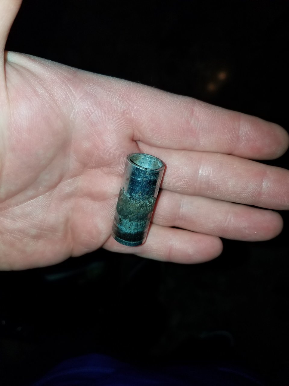

    pull apart and put a thick fender washer of the right ID above the collar for the boot and call it good.

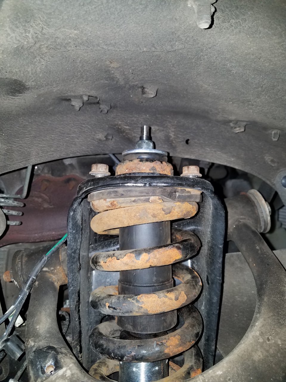

    Ok fellas, got em off and re assembled, added the bottom washers, got new top washers and bushings. It was the metal sleeve from the hat that was in the way.20190409_184157.jpg 20190409_193828.jpg

    Probably nothing but did you tighten the three nuts on top? They’re loose in the photo.
    Bebuchheit[OP] likes this.

    Oh yes, we were still putting everything together when I took the pics

    That’s what I figured. But would have felt like crap not saying something and you ran into a issue down the road. (Pun unintended)
