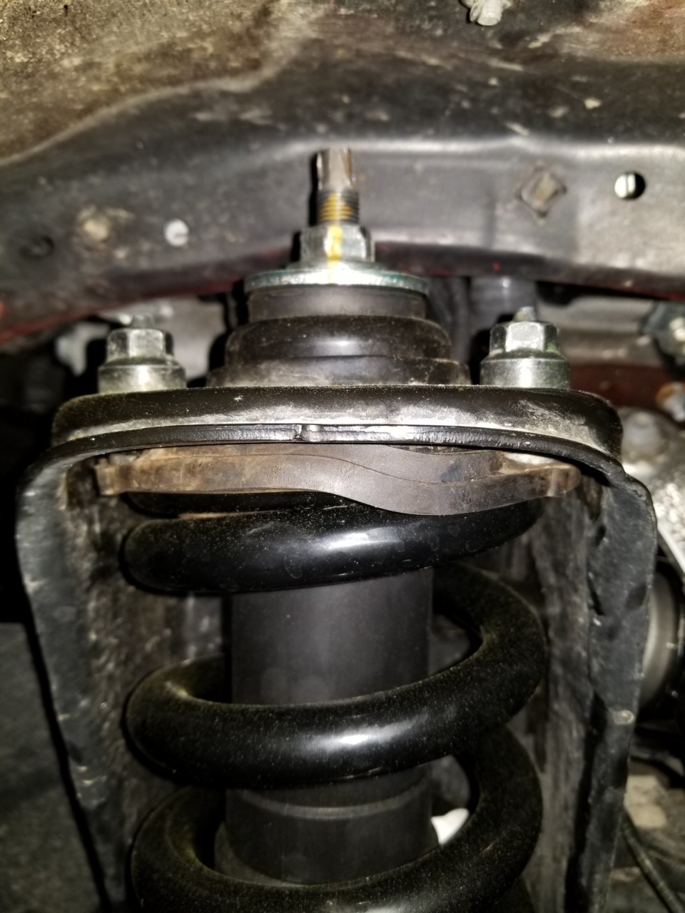

    Ideally, you want 2 jacks for this. Or at least put the truck on stands.
    You have to almost off the truck at the LCA with a jack to get it to compress enough. Also, you need muscle that top nut until it truly stops. Take another look at my pic and you'll see threads showing

    2016 Inferno TRD Offroad
