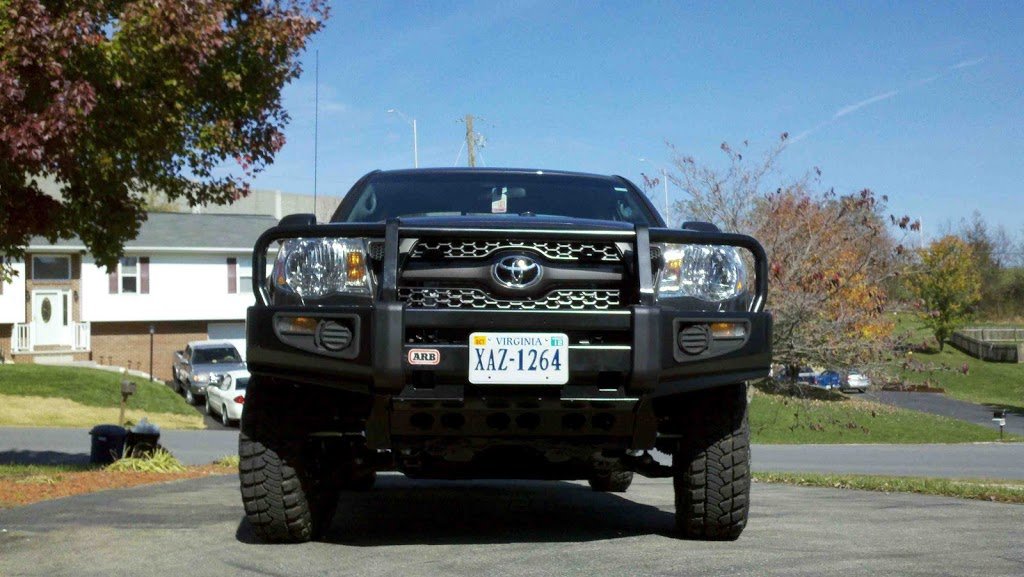

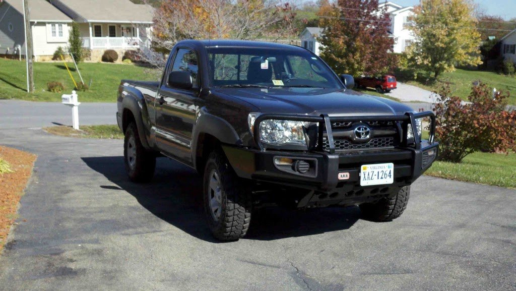

    Great answers bendbolden, thanks. Going to go w/ 1.75 on the 5100s and since the ARB bumper dropped the front end about 1/2" after install, this should be close. Thanks again.
    Here is how the truck sits now.
