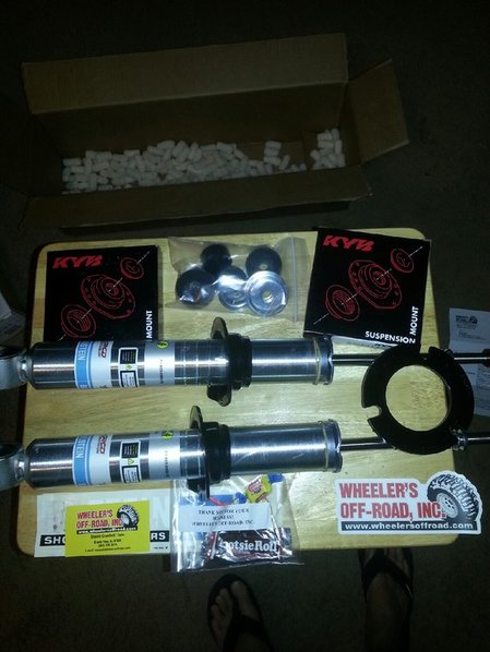

    I am in the same situation as you. UPS is set to deliver 2 Bilstein 5112 struts for my first gen. today. I will be re-using my stock springs. I want a little lift and the truck level or slightly nose down. The way I see it is you should set the front the way u want and then adjust the rear accordingly. I will be setting front struts to middle or lowest setting and adjust from there. Some people are saying not to use 5112 on rear of truck. Due to articulation required on the rear of your truck. Keep in mind, I am not experienced with this.

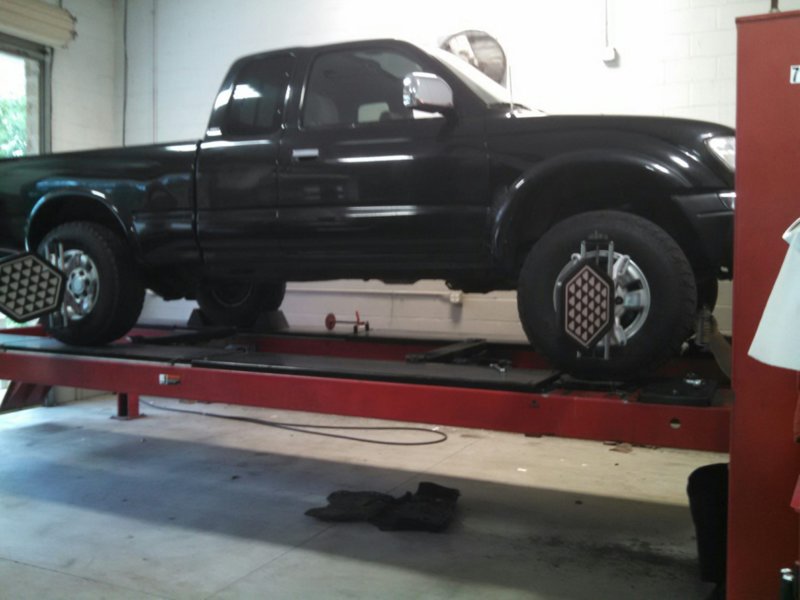

    OK, there here. I have 1st gen 4x4 V6 stock. Plan on going with the middle setting with I believe stock coils. Sound good to you?
    Also, are the height adjustable rings currently set to the highest or lowest setting on the struts? No instructions.
    HOW ABOUT WHEELERS THROWING IN SOME CANDY ON THE DEAL!

    Right and Right. Installed front struts middle position today and have a Bro Lean tonight. Plan is to end up with a slight nose down attitude.
