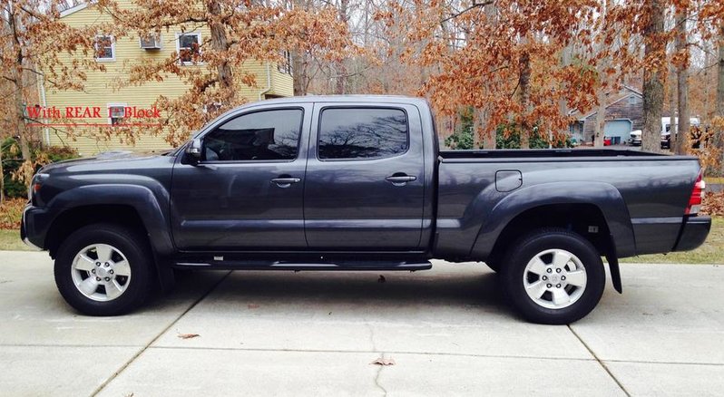

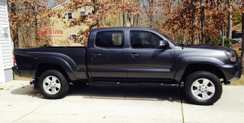

    Okay, I am finally finished. With just the 5100's up front set at 1.75 it measured level, actually 3/4 of an inch higher at the rear. Measured at center of wheel (axle) from the ground to the bottom of the fender well. It was 36 1/4 in the front and 37" in the rear. It sill looked like it was squatting in the rear. Not sure if its because of the lines of the truck, maybe the hood scoop throws it off.
    I had to add a 1" block in the rear to get the look I was trying to achieve. It ended up with a little rake but I think it turned out well. Tires next, here are the photos without the block then with.
