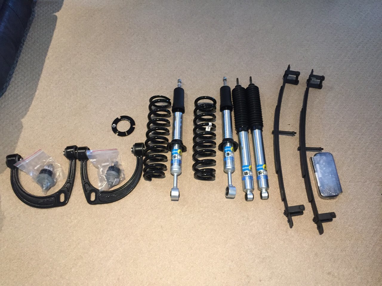

    Just got my suspension kit from HeadStrong off-road 2nd gen billstein 5100 all around with 888 OME springs, LR UCA's and 3 leaf aal for rear. Any one with the set up how do you like it?
    My 2017 trd off road right now with 3/2 inch blocks on can't wait to get them off and New suspension installed this weekend

    Sub'd I want to see pictures after I am about to buy this exact kit besides 887s. What knotch you going to?

    1st notch no height out of shocks just getting my lift from the springs

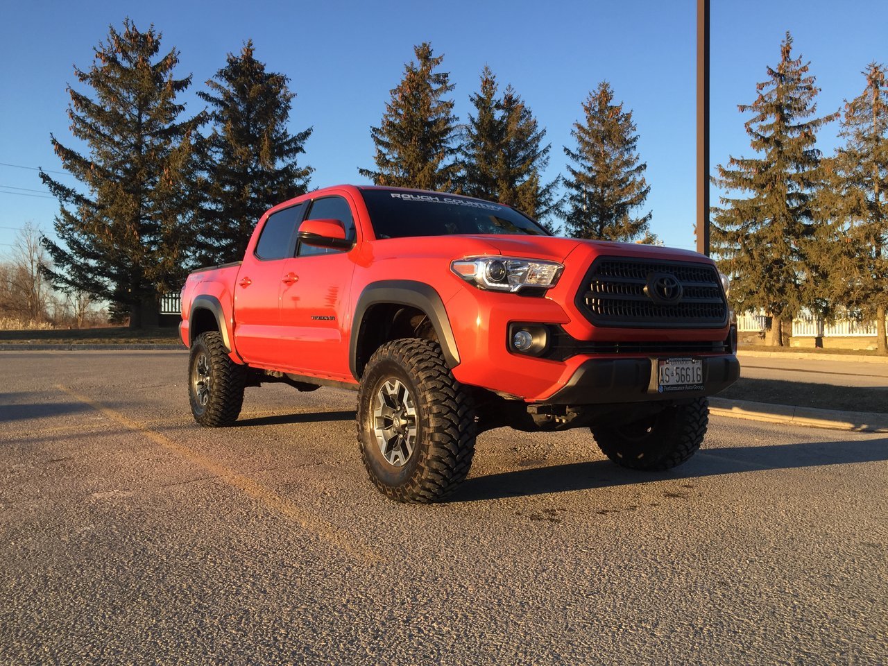

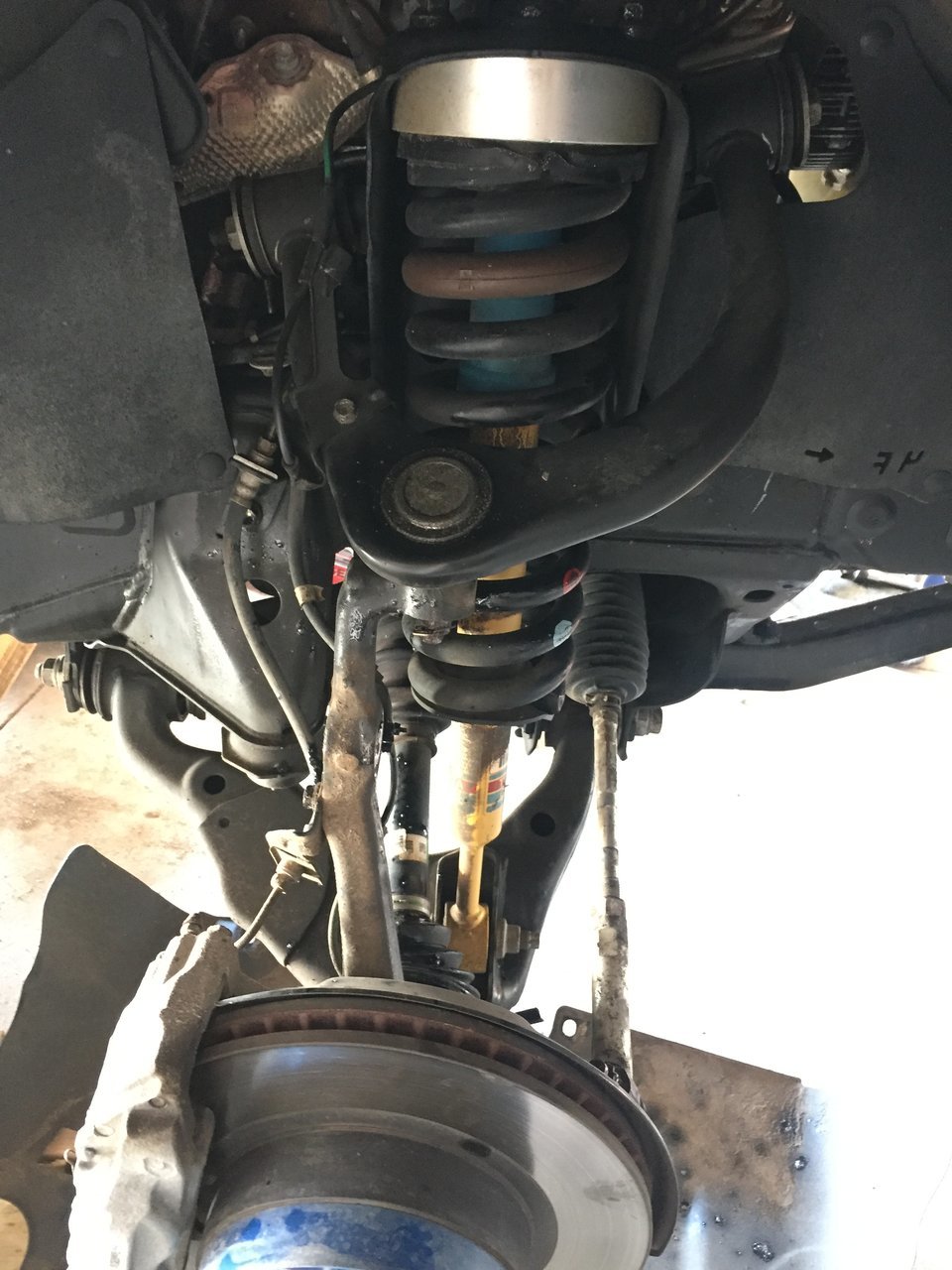

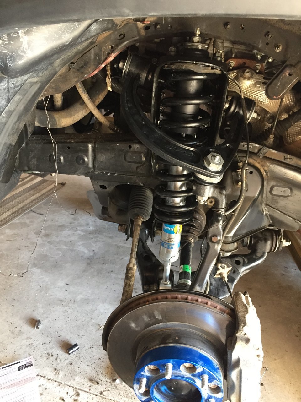

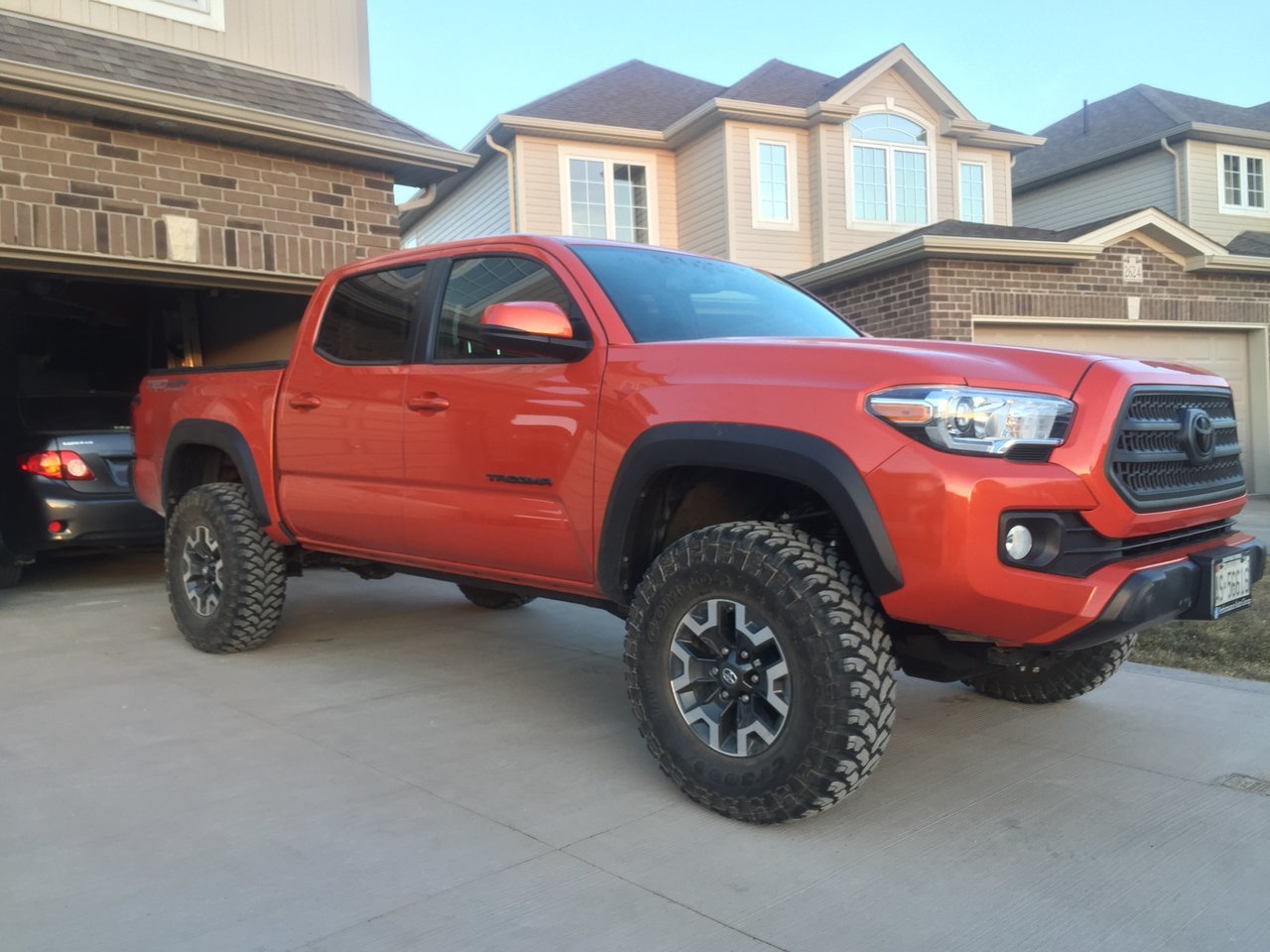

    I installed the lift over the weekend and am pretty happy with how it turned out. It rides 100% better then when I had the spacer lift. But now I have a bit of rubbing when turning and hitting bumps on the cab mount. So now it's time for a cab mount chop. How hard is it to do a cab mount chop with just a grinder and cutting disks or should I just take it in for a shop to do? 285/75/16 is my tire size. Here are some pictures

    Looks good!
