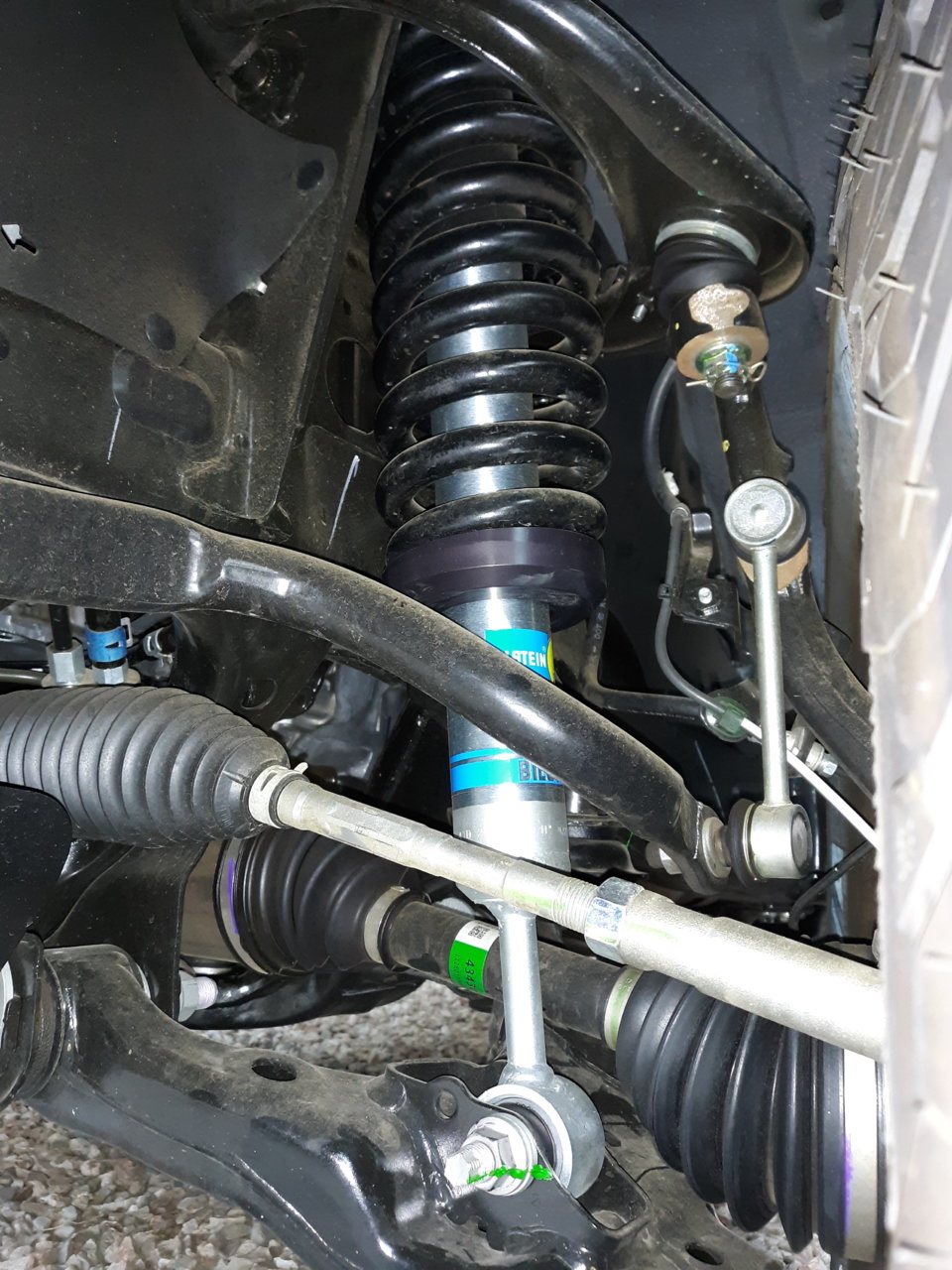

    This is my Westcott Design lower collar, which gives up to 3" lift and still give shock full range of up/down travel as OEM. My front end is 1/4" higher than rear, but expect a little settling, plus have rear air bag for heavy loads or towing

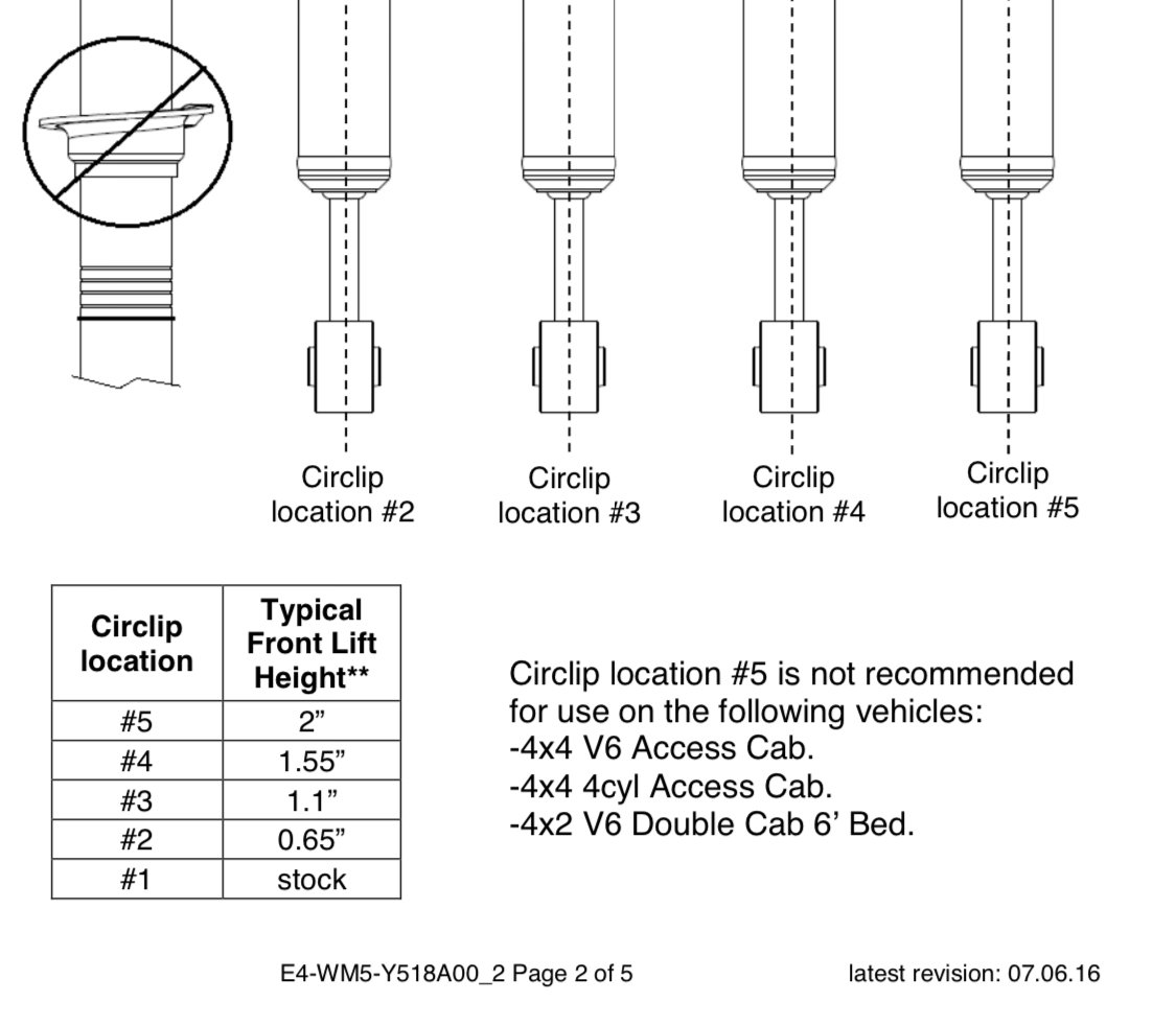

    Here’s a copy of the directions you should show the installer if they give you grief about redoing the job for free:
    https://productdesk.cart.bilsteinus.com//media/products/bilstein/E4-WM5-Y518A00_2.pdf
    I would consider putting in a single AAL and keep the overload leaf in back to level it after the front end lift. Also, keep in mind that they were right about not putting it on the 5th clip as per the directions from Bilstein for certain Tacoma models:

    They screwed up big time. Even at 5th notch you would be at 2" of lift and nose just a touch higher than the rear.

    Got mine on the top setting @ 2" and absolutely love it. (Stock coils as per Bilstein recommendation.) 1" block in the rear.
    It's literally what the new OEM TRD lift kit includes
