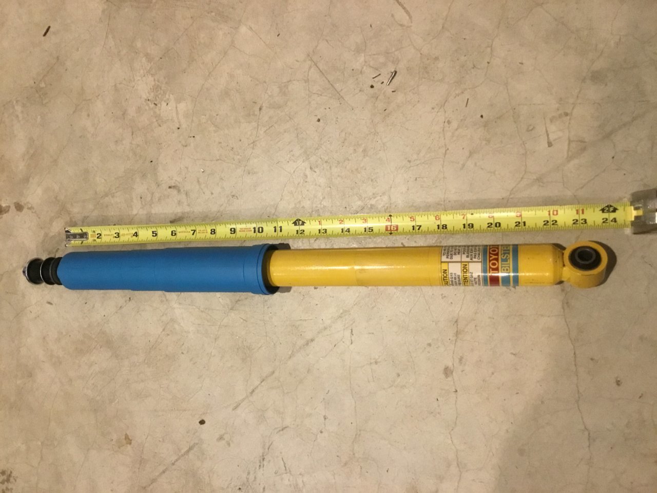

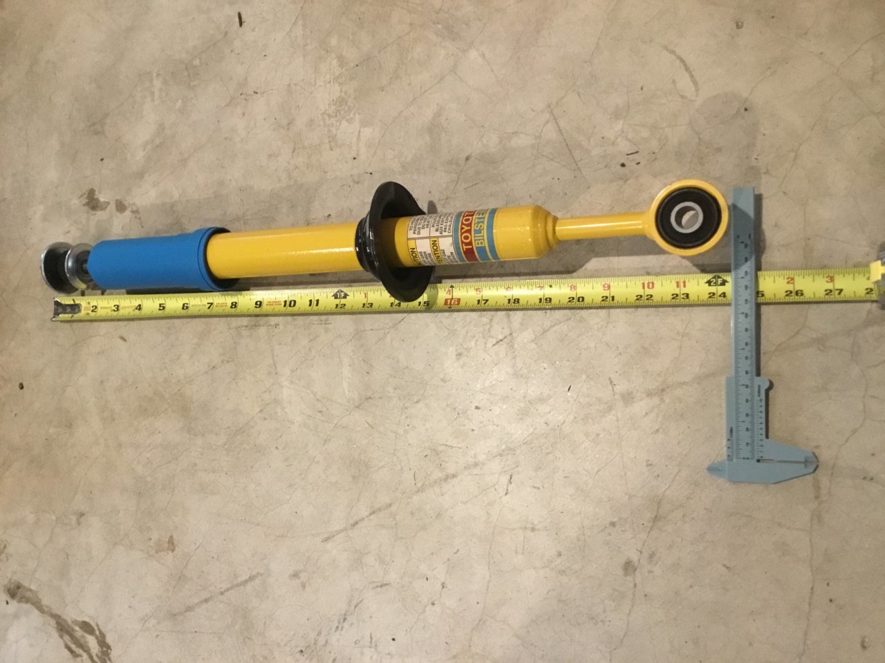

    Just measured the stock shock. Total length. Bottom to top.
    24 3/8 extended.
    About 20 5/8 compressed.
    From center of bottom mount hole to top of the lower rubber bushing is about 21 1/2 extended.
    From center of bottom mount to lower washer is about 21.25 extended.
    1 inch difference would seem about right for a 0 to 2 inch lift.
    I was guessing about an inch difference from the first picture, = 1,000 words.
    Sorry if this still doesn’t help.

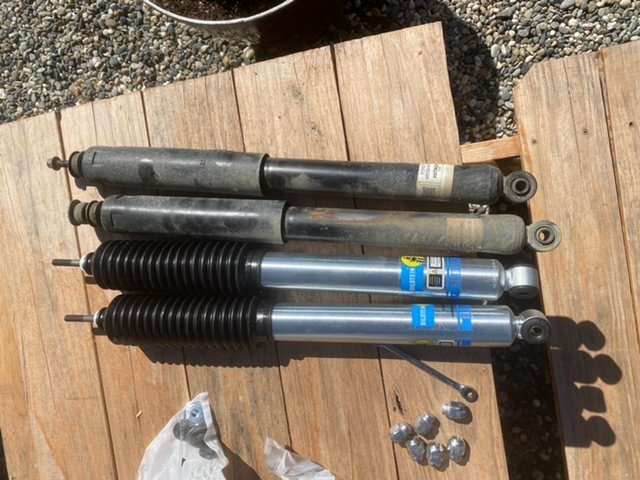

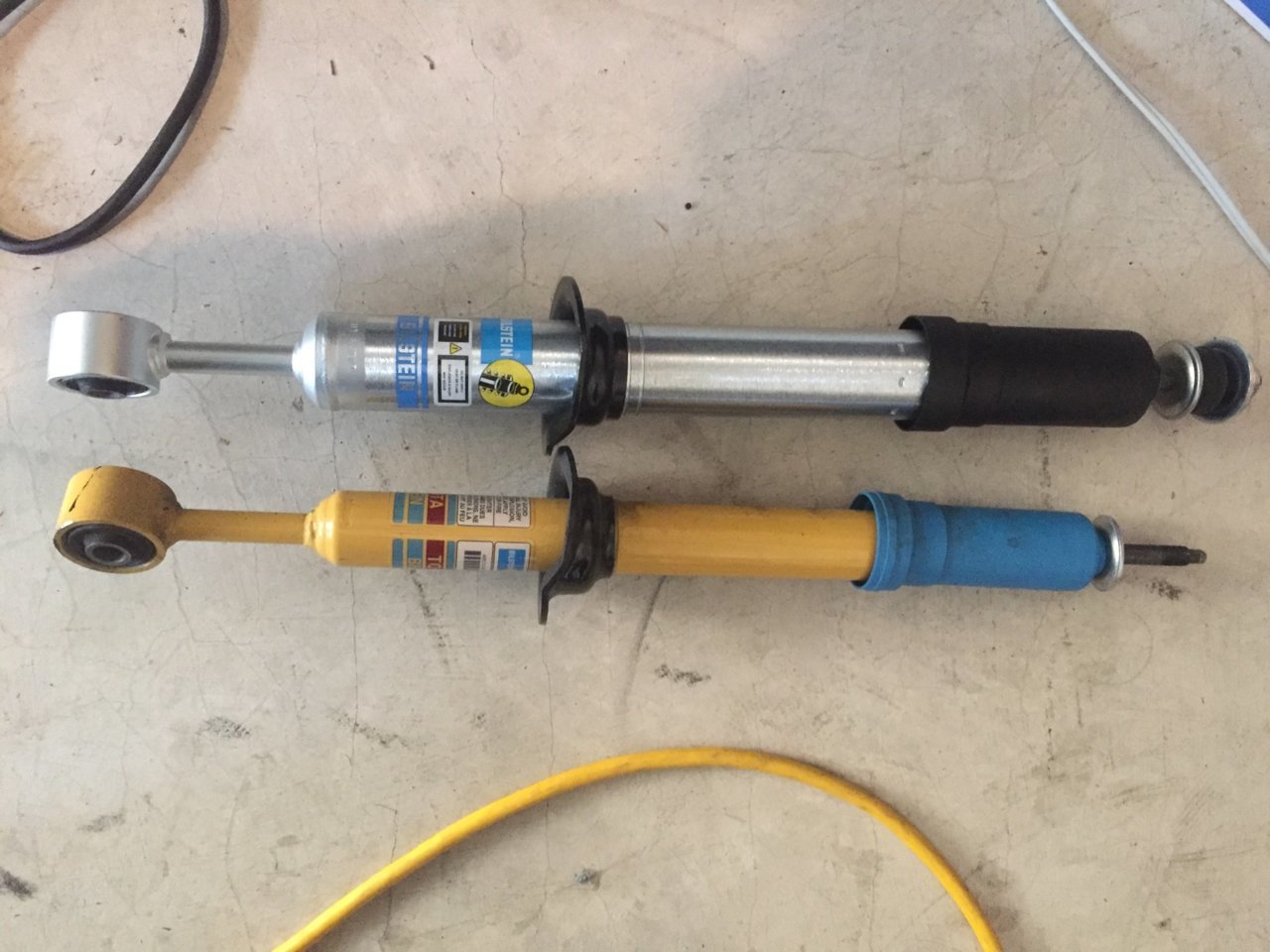

    Still have them two years later.
    Stock Bilsteins.
    Extended-23 inches from center of bottom mounting hole to lower washer.
    Compressed-About 14.5 inches from center of bottom hole to lower washer.
    In the picture from two years ago, they look to be about the same length as the 5100s extended.
