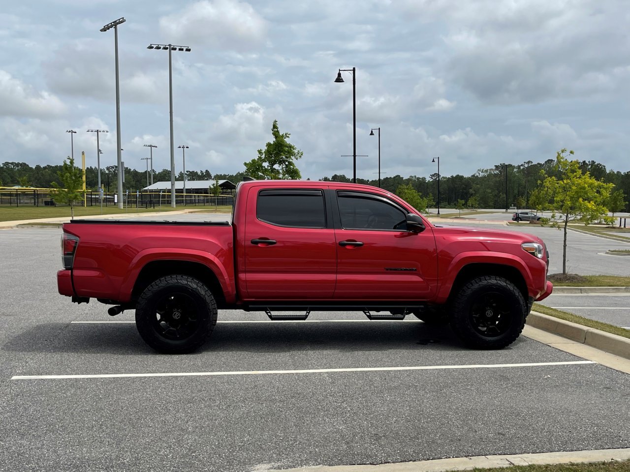

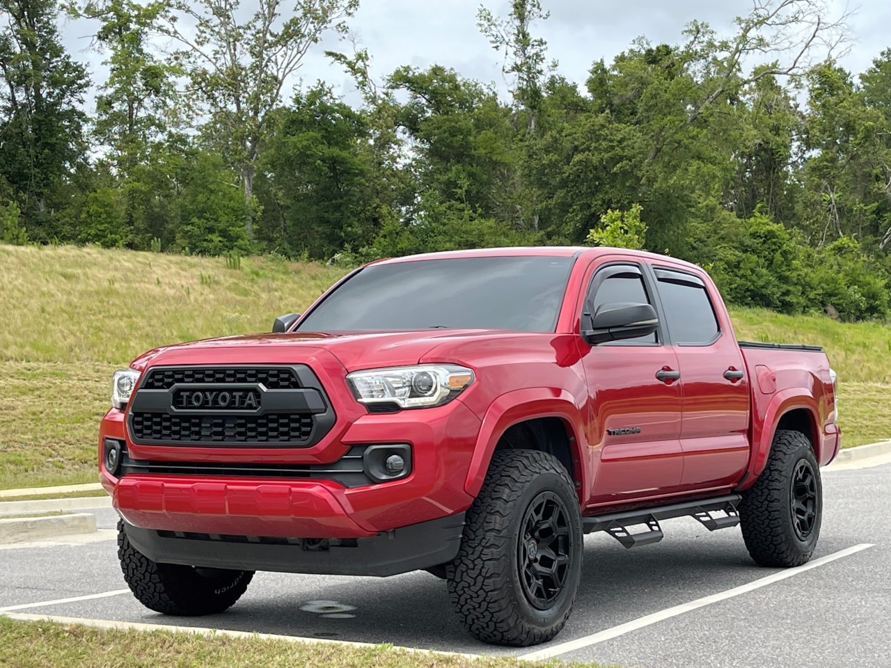

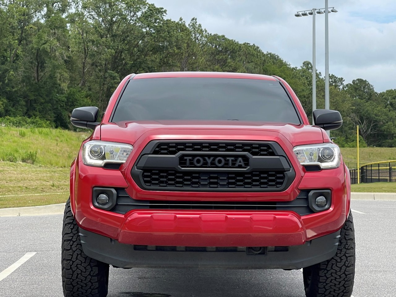

    After months of reading countless threads about what to do or not to do, I decided to go with
    the bilstein adjustable 5100 shocks for front, and 5100 shocks for rear, stock height. I set the clip on front @ the .65 setting. For me, it seems to have worked very well, with only a slight bit of the factory rake remaining, which is what I wanted. I had a shop install them, and they did it incorrectly the first time. I had about a 1/2" gap between top bushing and the top nut. What I learned after talking to Bilstein, was that there is a bushing inside the dust cover, and for some reason the shop didn't use them. Once they dug them out of the trash, and put those on, everything is snug. The ride now is slightly stiffer than stock, but feels more planted when braking and turning. So far, I really like them. Truck15.jpg truck06.jpg truck08.jpg

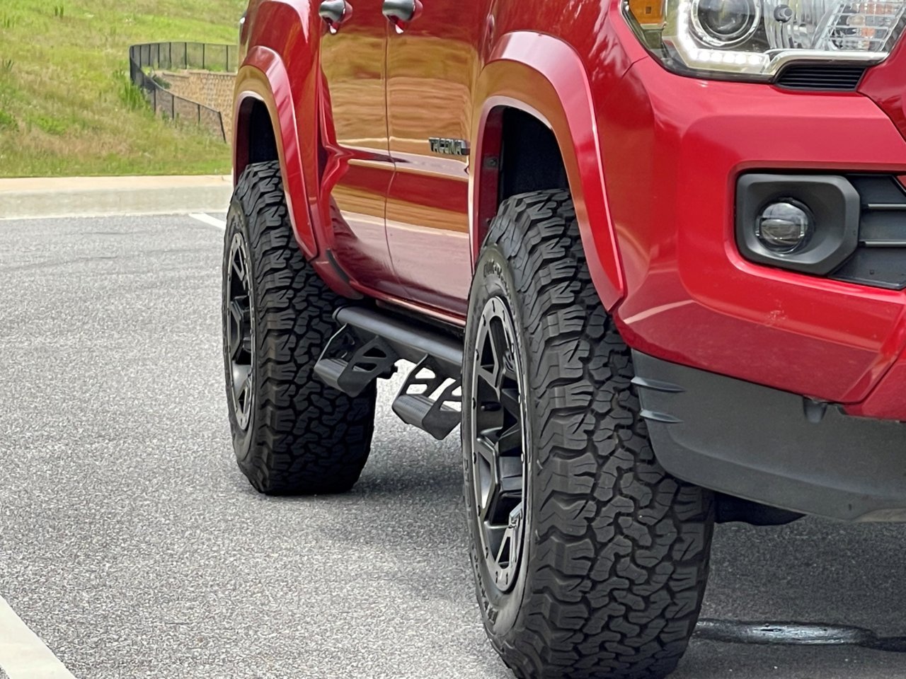

    Thank you for the comments. My wheels are -
    Black Rhino Overland Matte Black 6-Lug Wheel; 17x9.5; -18mm Offset
    Tires are BF Goodrich All-Terrain T/A KO2, 265/70R17

    Looks good. I like the poke
