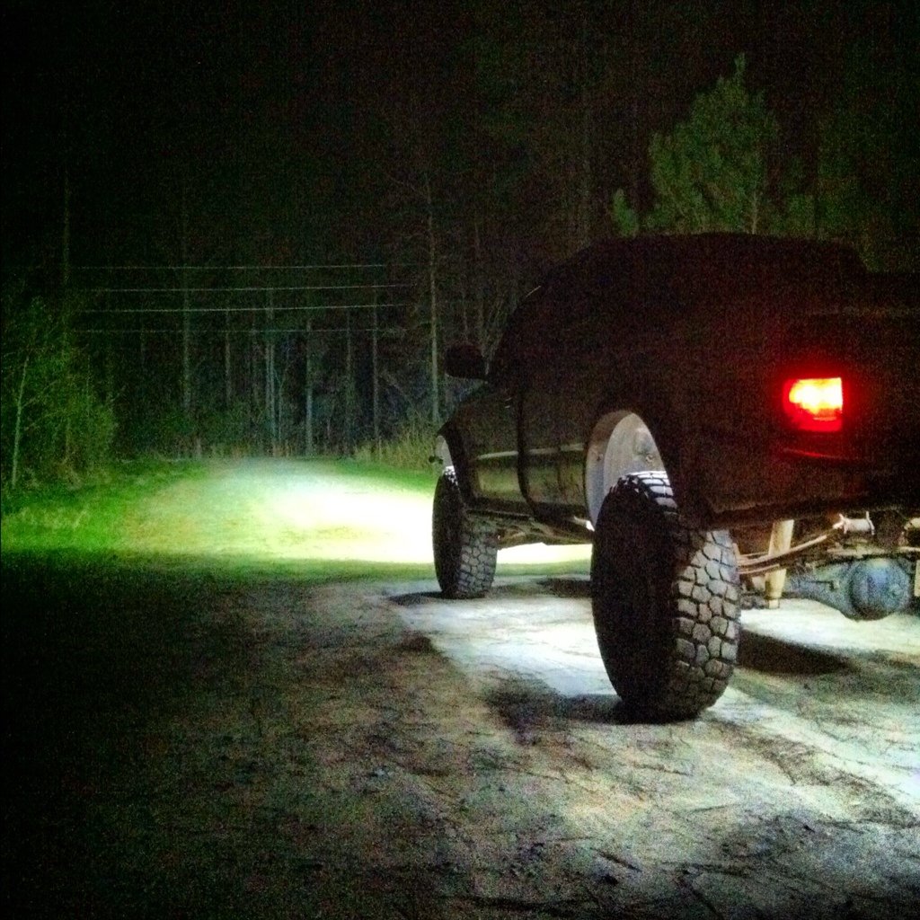

    5100's with eibachs, custom leafs in the rear with 32" km2's
